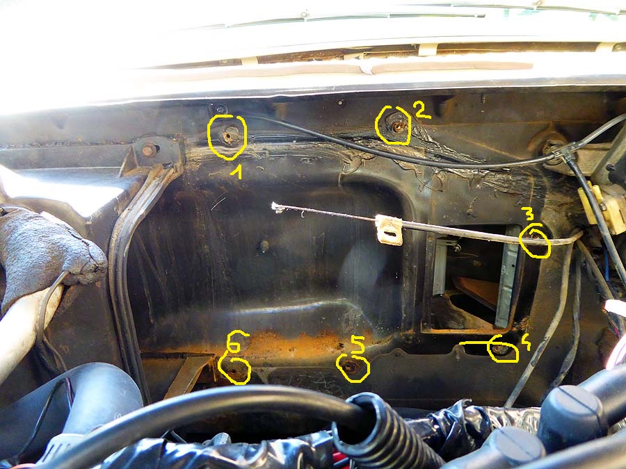

1) screw off everything from above the Heater box (cables and heater valve) , but not the small vacum! - see pics
2) crew off the 6 screws of box, nr. 5 and 6 from underneath - sorry... first you think it don´t work but it is easy and possible :)
3) take of a box to the left site
crews, nr 5 und 6 are a small "problem"
aircondition rechts and heater part left

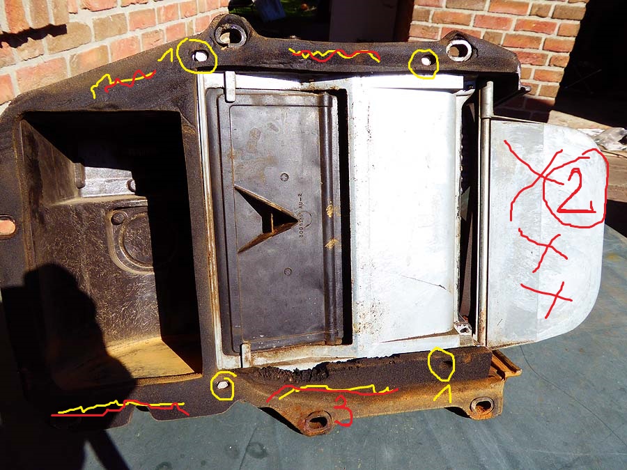

everything put down from the box...
first carefully!!! rubber - my was in a very good condition and i use it again
then 4 small screws,
then small vacum regulater - mark the crew position!!! then flap at the front,
and than you can see your problem :ugeek:
put it down everything
make a mark for the screws!

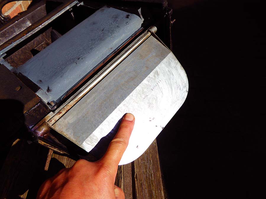

Postby Jelonek » Sun May 06, 2018 5:54 am
4 small screws at the front and rear of heater :D :D and put down the broken heater
than everithing clean
and put everithing togather again :arrow:
rubber for the windows :) as a seal
clean and liitle bit spray

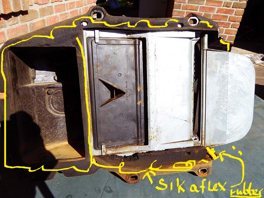

Postby Jelonek » Sun May 06, 2018 5:57 am
I put a little bit sikaflex rubber on the ald rubber.. and to the switch space (?) to the aircondition box ( i hope you anderstand me :)
sikaflex-rubber
sikaflex-rubber

Re: Hello from Germany!
Postby Otto Skorzeny » Sun May 06, 2018 6:16 am
That does look pretty easy. I'll have to do mine before next winter.
Is the Sikaflex a silicone type sealer like the type used on bath tubs and sinks?

that with sikaflex and silikon :shock: i will check .....

Postby Jelonek » Sun May 06, 2018 1:01 pm
sikaflex 521 uv is not a silikon... only a fluid-rubber, very stable and elastic, i use it in a home, car, everywhere, last time i repair with it my cv-rubber boots and it works perfect (i didn´t believe it... :lol: )....
