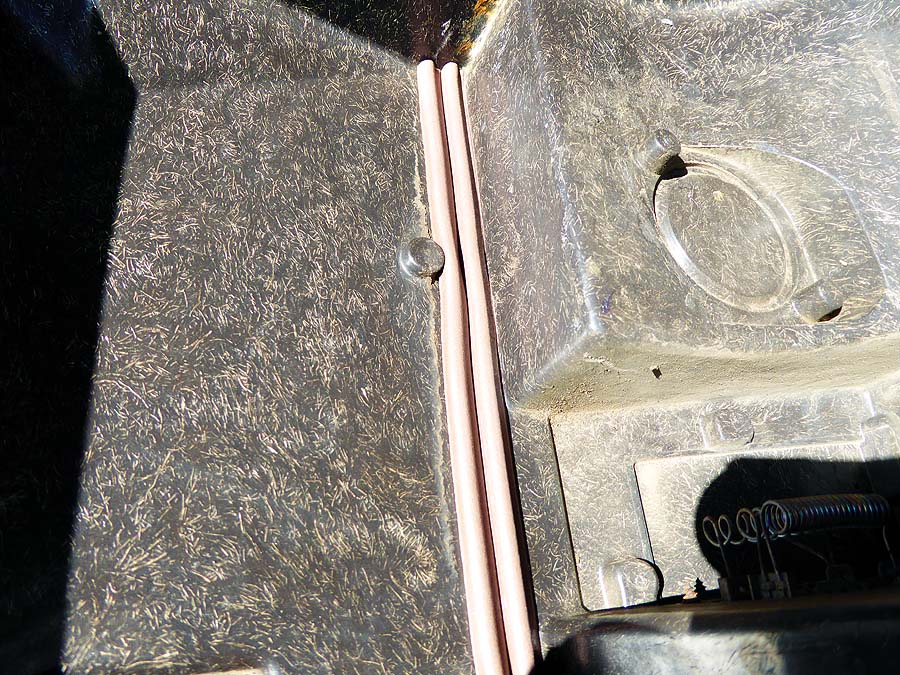

the aircondition and heater has a constraction of two parts, it is necessary to put down only the left one ( left - driver site !!!) -
1) screw off everything from above the Heater box (cables and heater valve) , but not the small vacum! - see pics
2) crew off the 6 screws of box, nr. 5 and 6 from underneath - sorry... first you think it don´t work but it is easy and possible :)
3) take of a box to the left site
crews, nr 5 und 6 are a small "problem"
aircondition rechts and heater part left

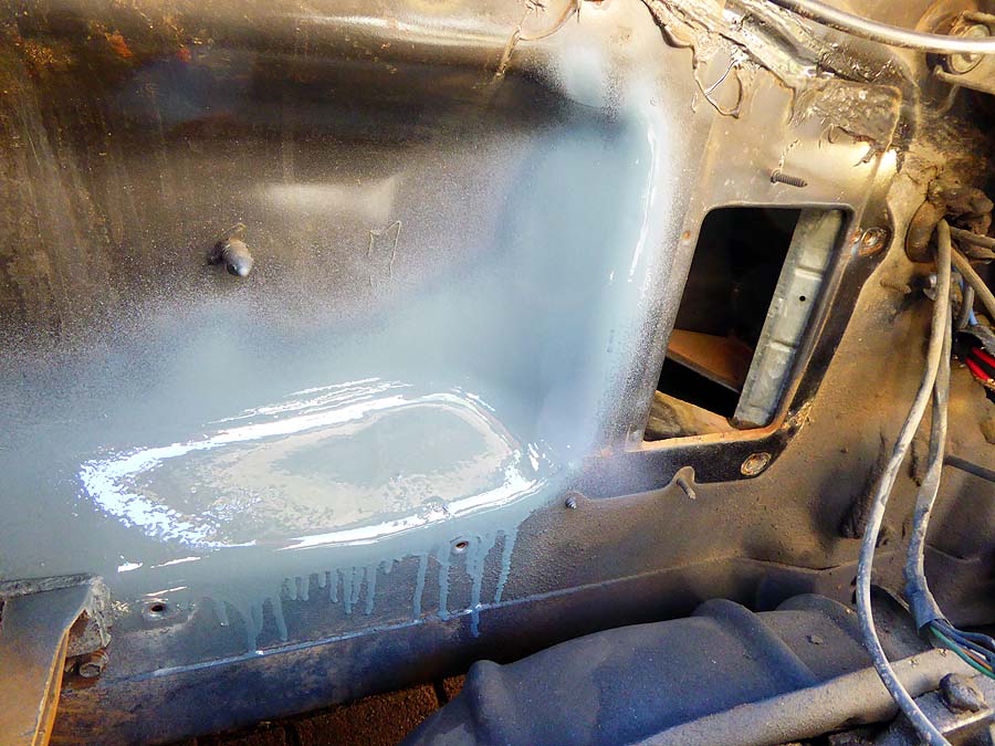

4 small screws at the front and rear of heater :D :D and put down the broken heater
than everithing clean
and put everithing togather again :arrow:
rubber for the windows :) as a seal
clean and liitle bit spray

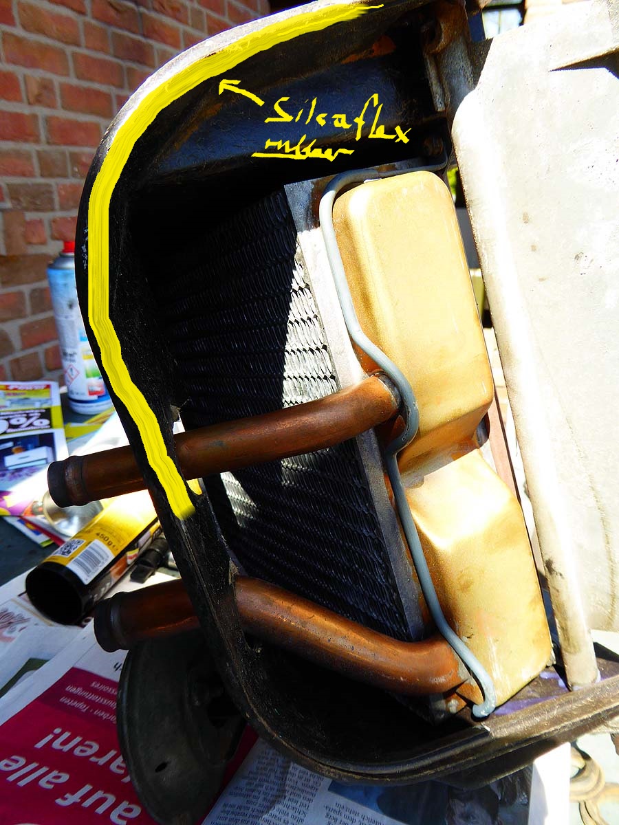

Postby Jelonek » Sun May 06, 2018 5:57 am
I put a little bit sikaflex rubber on the ald rubber.. and to the switch space (?) to the aircondition box ( i hope you anderstand me :)
sikaflex-rubber
sikaflex-rubber
