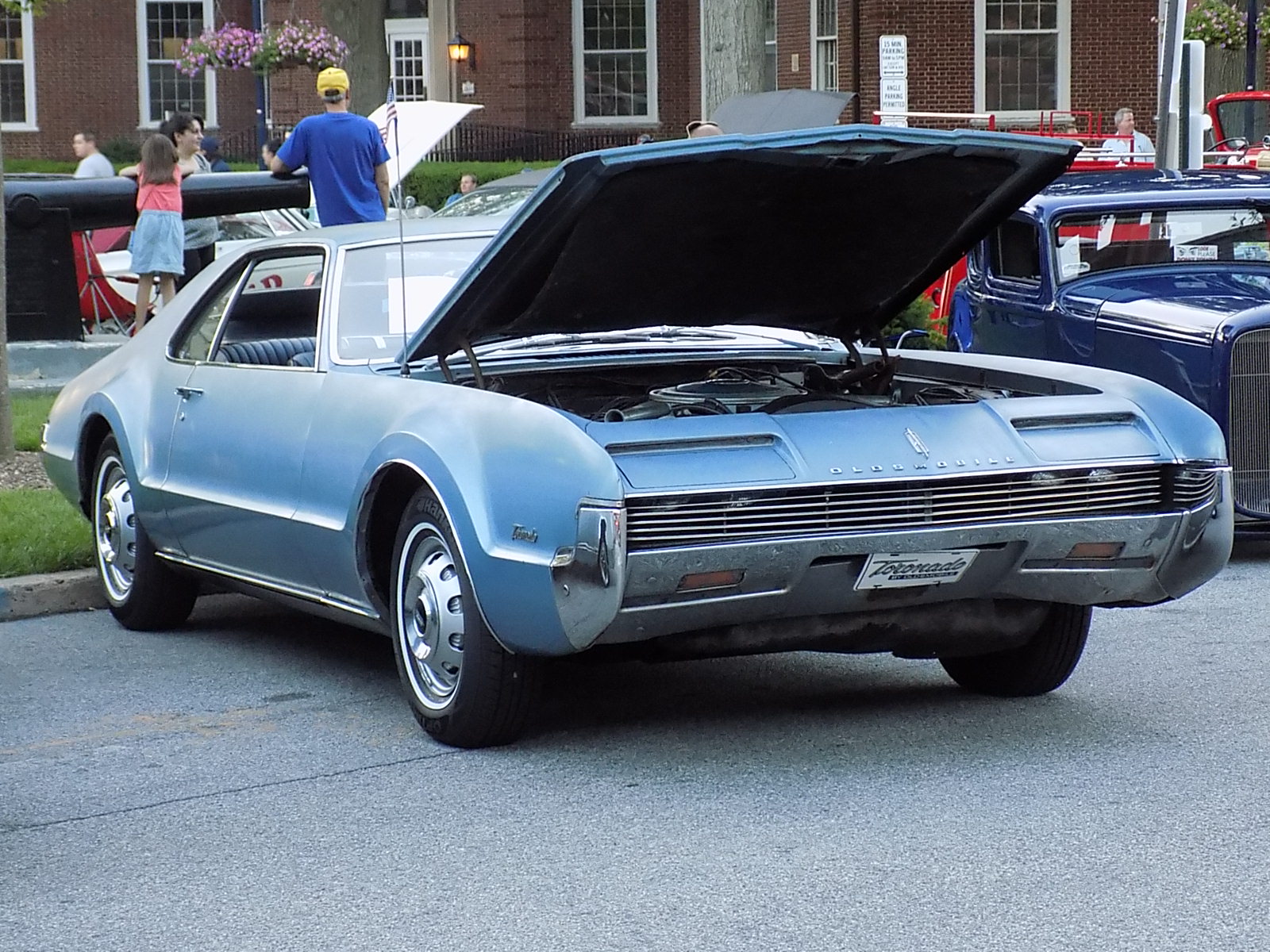

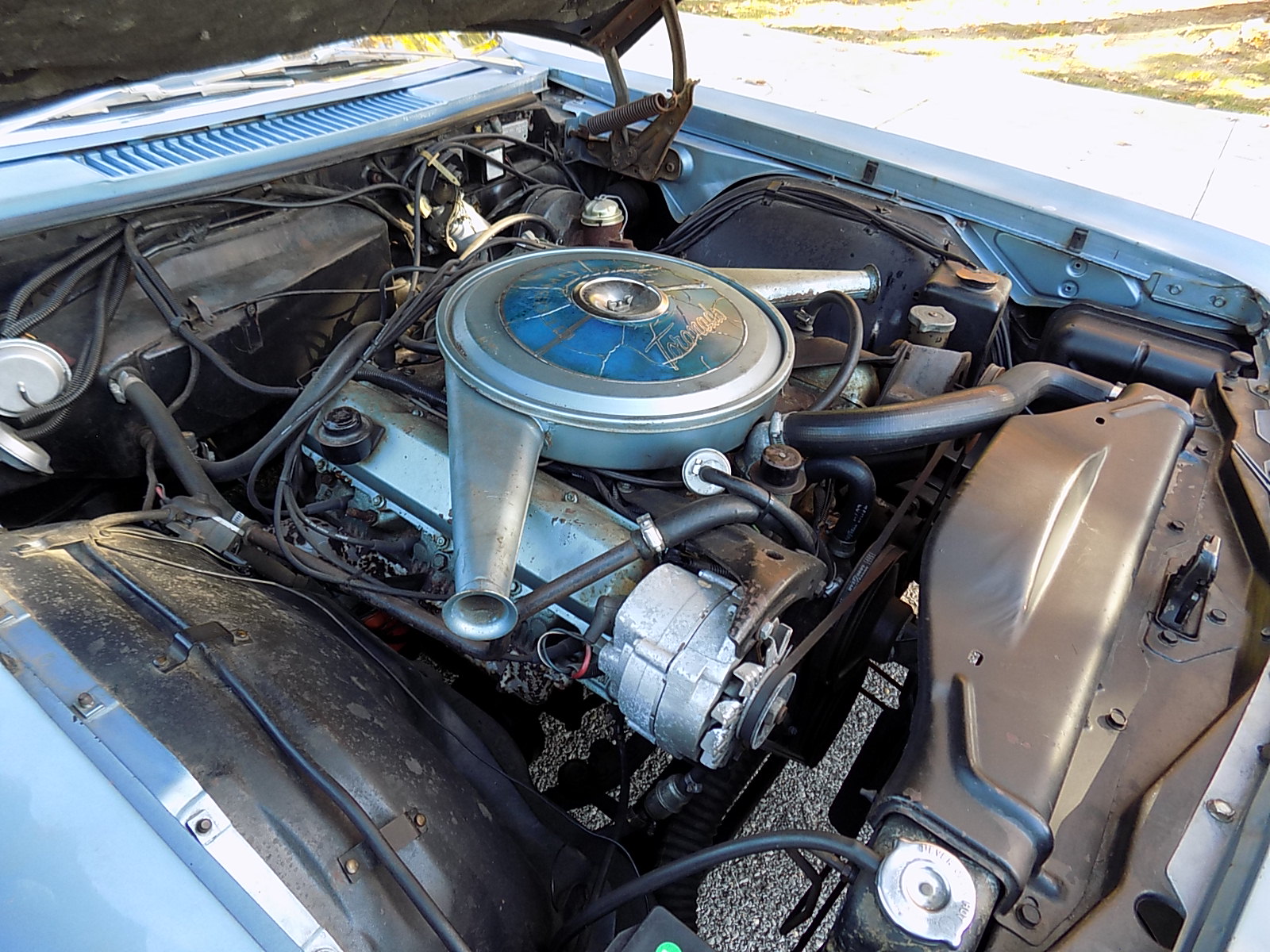

That sounds like a good plan. Glad to know you're making progress. The stencil is a perfect idea.
I got my car about a year ago from a long term storage.
I replaced all the fluids, tires, blasted and painted the wheels, went through the brakes (they were pretty new) overhauled the headlight actuators, fixed all the lights, rebuilt the RF axle and replaced the outer boot, replaced the mirrors and the rear cowl drains.
Other than that, I've been driving it and having some fun. It gets smiles, waves and questions just about every time I take it out. I need front seat upholstery, carpets, maybe a paint job and some chrome. But it's a nice survivor as is. I have other cars in the cue to restore before this one.
I took it to GM Nationals this summer for the 50th Anniversary celebration at Carlisle PA where I met the designer, David North. He was a delightful man and signed the dash for me. He had some interesting stores to tell. One was about how the rear taillight panel was rushed, and somewhat cobbled together. The whole rear panel was intended to be tail lights, but the tail light supplier (Guide) couldn't execute in time so they went with the half body color, half lens design.
