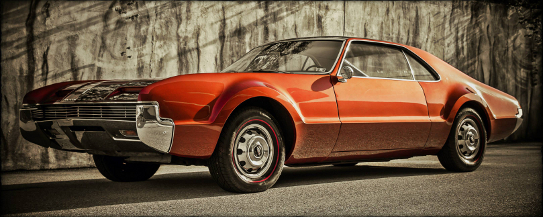

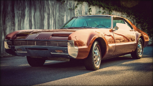

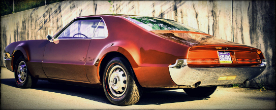

It's been a bumpy and expensive road, but I'm taking my 1966 Toro to the GM Nationals car show in Carlisle PA.
Here's a brief overview of what's been done to the car. I still have a couple of little projects, but she's about 95% complete
- MSD Atomic Electronic Fuel Injection
- Electronic Headlight Actuators
- New Exhaust , 2 1/2"
- Copper II Pearl Exterior Paint (House of Kolor)
- Shaved Door Handles
- Door Poppers
- Removed original fan and fan shroud
- Aluminum Radiator with Electric Fan
Custom work by Keystone AutoKrafters
https://www.facebook.com/keystoneautokrafters
Photography (Exterior) MSW Photography
https://www.facebook.com/M.Wilson.Photography
My First Car Show for My '66 - the GM Nationals

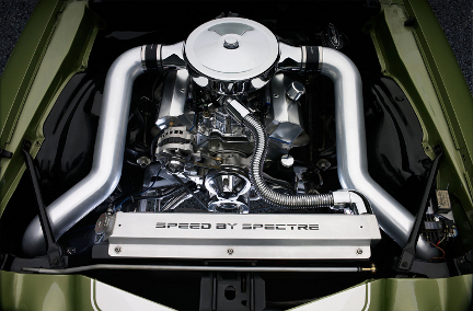

I have replaced the vacuum headlight actuators with electric ones from a Ford Probe and am relocating the battery to the trunk where it will be enclosed in a marine battery box. This frees up all the space I need to run the intake from both sides. I have two options at this point for the intake.
1. fabricate a mounting bracket that sits just inside the grill for each side attach to.
2. mill out the plates that sit just above the flip up headlights and fabricate a mounting bracket there.
The second option would be much more difficult and I'm not sure that there will be enough air flow, but is the most elegant solution.
I will probably go with the first choice since it is the easiest and most efficient.
Specter performance makes low profile plenums that will fit under the hood even with the Toronado's notoriously short hood clearance.
Add some in-line air filters and that should be it.
the pic below is my inspiration

I just ordered my single input low profile plenum kit with the inline airbox:
I am going to remove the vacuum canister and use that space for the intake. I had not though of relocating the battery; I do happen to have some 4 gauge wire I could have used. Oh well, this will work well enough but yours will look much cooler!
