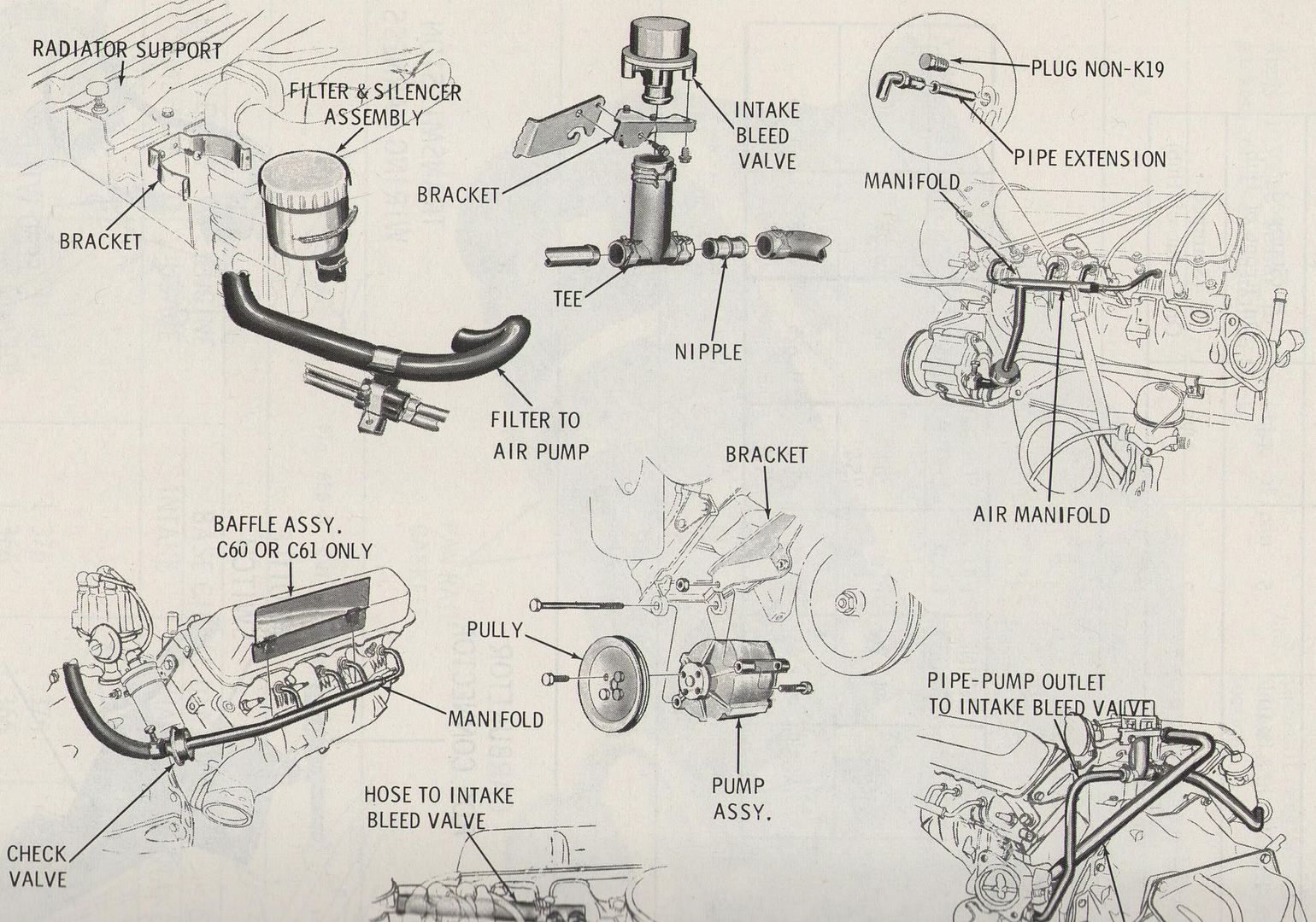

Odd question, very unrelated to the original topic, but I.noticed when I was looking at my engine the other day, there are plugged ports on the cyllindar heads. These were a delete for the AIR system the california cars were equipped with. Could these hypothetically be utilized to make a direct injectiom system? Not that I would, just curious though.

xgecko wrote:Hooboy. Direct Injection. This is a very modern design that is much more than just ports. Key is an injector that can survive the combustion and pressures developed in the cylinder and heads redesigned for the DI injectors. I am not totally sure which ports you mean
These ports, it's hard to tell weather they go into the cylinder, or the exhaust flow... They were used only on california cars, but all of them had the plugs.

Twilight Fenrir wrote:I.noticed when I was looking at my engine the other day, there are plugged ports on the cyllindar heads. These were a delete for the AIR system the california cars were equipped with. Could these hypothetically be utilized to make a direct injectiom system?
No. They would spray fuel into the exhaust stream, as they're more-or-less aimed at the back of the exhaust valve.
Useless for running an engine.
