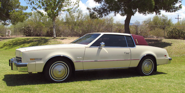

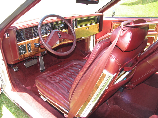

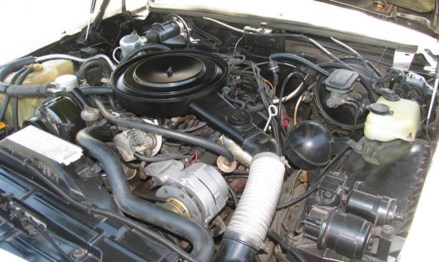

				- The Restored Queen Mary 70a.jpg (91.49 KiB) Viewed 11552 times
				- The Restored Queen Mary 50a.jpg (188.92 KiB) Viewed 11552 times
				- The Restored Queen Mary 01a.jpg (142.77 KiB) Viewed 11552 times
