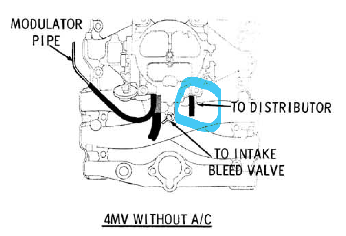

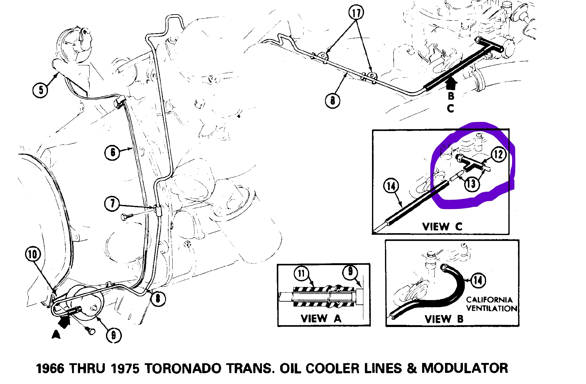

On the first picture, yours seems to be connected to the transmission modulator line.
This is the answer that I got from a Facebook group :
Tim Hubler You're all wrong. That bolt was used in 1967 Toros equipped with the K-50 option, the Climatic Combustion Control air cleaner. That is the source of manifold vacuum that operates the vacuum controlled doors in each snorkel.
Then this post :
Ralph Hupfer OK guys, I stand corrected. IT is a factory bolt, on 67 with CCC. I have been in Olds parts from 69-80 and have never seen or had a call about it. I did not believe it. You gotta be kidding! Here's the part number for it. Ha
So I don't really know as I had so many different answers. But I have looked the manual and nearly every sections, I don't see any mentions of that bolt or any diagram where a vacuum line is plugged on that bold. But on the other hand, this is not the first picture of a 66 that I see with this bolt, for example, on the website of Sparky http://www.sparkyscarbs.com/October%20043.jpg
What to believe, what not, does it even matter ? :)

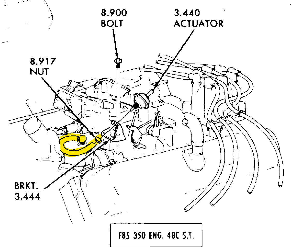

Ok thank you Otto and Tuco, this is what I found so far...
We all agree that the transmission line goes to that green input where I have a tee. Dashpot for the throttle goes to intake vacuum, so either on a plug at on the intake manifold as shown on the diagram, or to the red bolt that we have on the back. But it seems to need a check valve and I don't understand why... maybe to have a slower release ?
Then comes the subject of the distributor vacuum advance, many many websites are arguing about the fact that it should be plugged to the direct vacuum and not a ported vacuum https://classicoldsmobile.com/forums/general-discussion-33/ported-manifold-vacuum-advance-113536/, as it seems to make more sense to me, I'll just keep it that way and let it on the tee. I found a diagram where it is connected to the ported vacuum, but that's with the K-19 or K-20 option. Sadly I can't find one in a normal configuration.
So it seems like the ported vacuum on this carburetor is not used, as on many of the 7026250 it is either not present or plugged.
My goal here is to have a reference for anyone who wish to work on a Toronado and have everything right the first time :) So your contributions are more than welcome.
