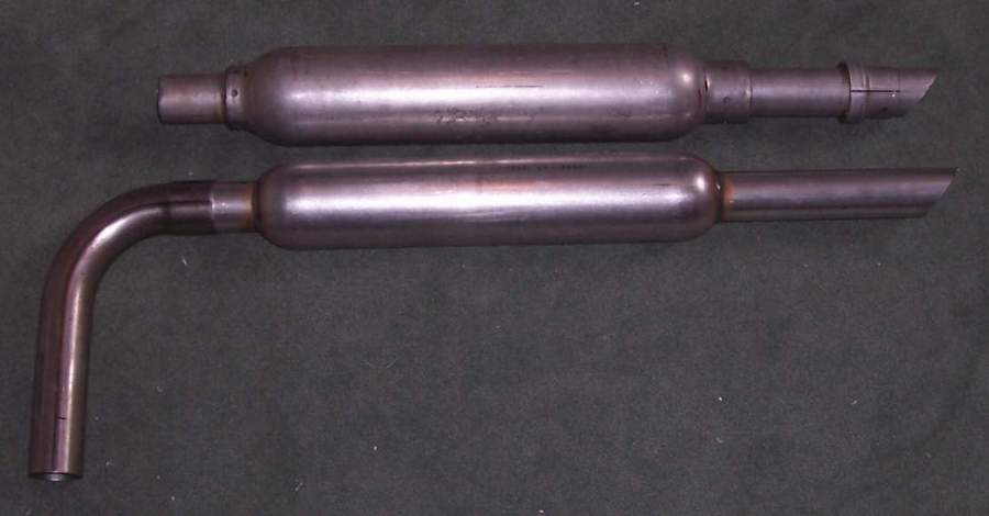

Here's a few photo of what the resonator look like
#1 is of the NOS and Repo side by side

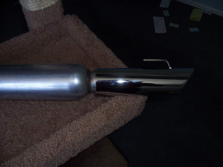

#2 close up of the NOS tip area

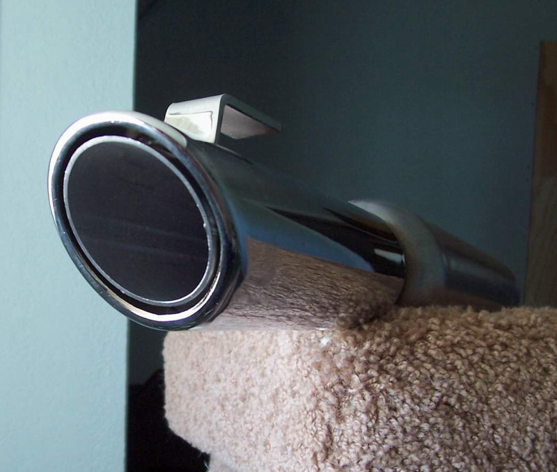

#3 Repo with collars loaded

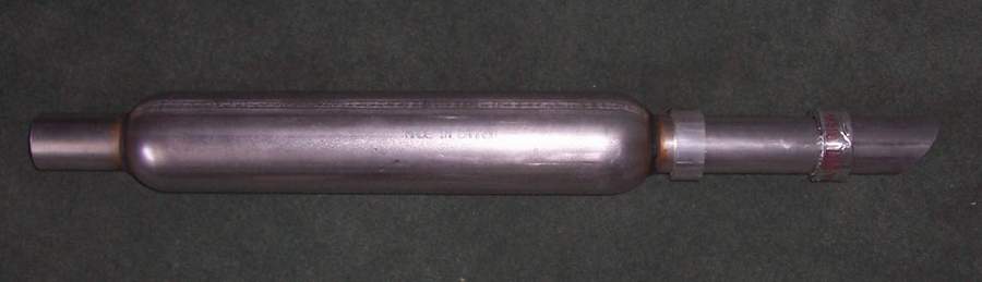

#4-5 with tip loaded on reproduction resonator
There are 3 holes on the of the chrome tip the larger is a drain. the two smaller affix the chrome tip to the collars, the 4th hole will be found on top of the 67 resonators as it employes a hanger system with a large course self threading bolt that screws all the way through the tip and collars securing the hanger to the Tip /Resonator, All screws pertaining to affixing the tips to the resonator and the 67 hanger system if required are supplied.
