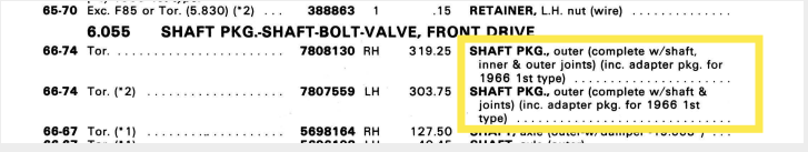

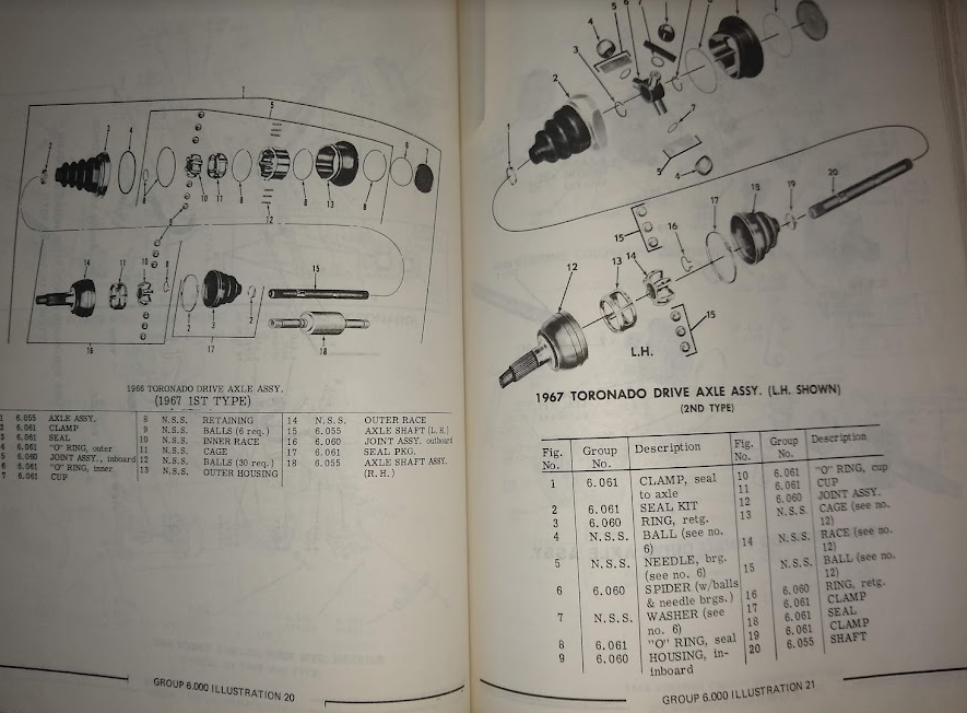

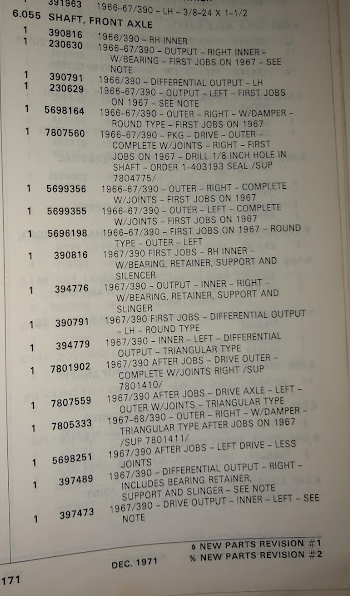

Well, I'm not too sure of the differences other than what I can see in the parts catalog (see my attached photos from my 1971 parts catalog).
It looks like the 66's and the early 67's used the same design which has a round inner flange. This is referred to as the "1st type". Later, in 67, they went to the "2nd type" which looks a bit different.
Now, I have no idea if these are in any way interchangeable. Later parts catalogs (1975) list them under PN 7808130 (RH) and 7807559 (LH) but this shows as including an adapter for 1966 "1st types". I have no idea what that means.
I don't have any particular preference with any of this other than I would like to order up a CV axle that will bolt right in and not have me standing there with a part that won't work. Just trying to avoid some aggravation I suppose. The offerings on RockAuto actually look like the 1st type to me, rather than the more popular 2nd type but the PN they list (GM8111) doesn't match up with anything I've been able to find as correct.

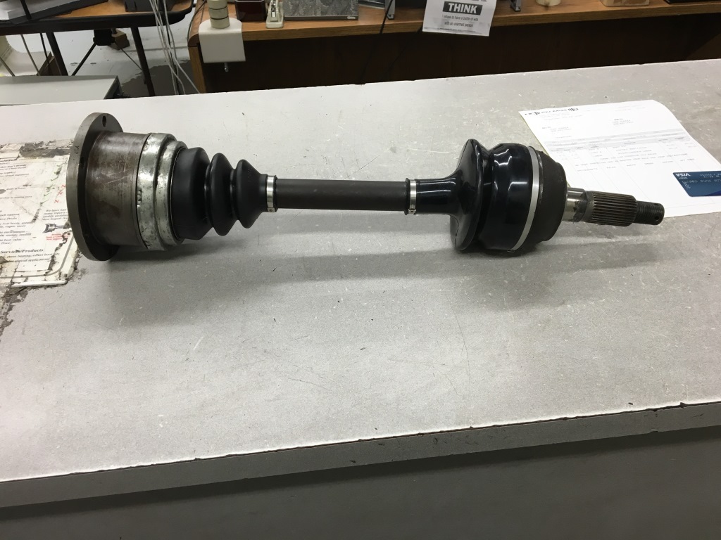

Re: 66' Toro CV axle
Your axle should look like this, if it's the original.
