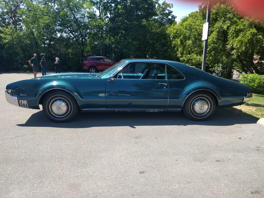

I have had some experience with the Toronado's Comfortron automatic climate control.
The first car I ever drove was a 1967 Toronado. I got to know and made minor repairs to its Comfortron system over the years.
I became the proud owner of a beautiful 1967 Toronado on August 7, 2020.
I had a chance to calibrate its Comfortron system, which works like a charm. And I possess a Comfortron tester model J 22265, which I would be pleased to lend to anyone who may need it (although you can diagnose most of the basics without it).
I would also gladly share my experience, and offer my thoughts to anyone working on the system.

That's pretty cool. Thanks for the offer. Your car is gorgeous.

Thanks for your comment, Otto.
I love the colour of your Toronado.
It must make quite a hit wherever you go.

I just noticed that your car has the correct thin stripe whitewalls. Are they from Diamondback?
