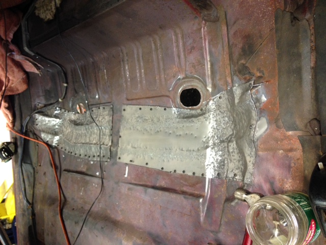

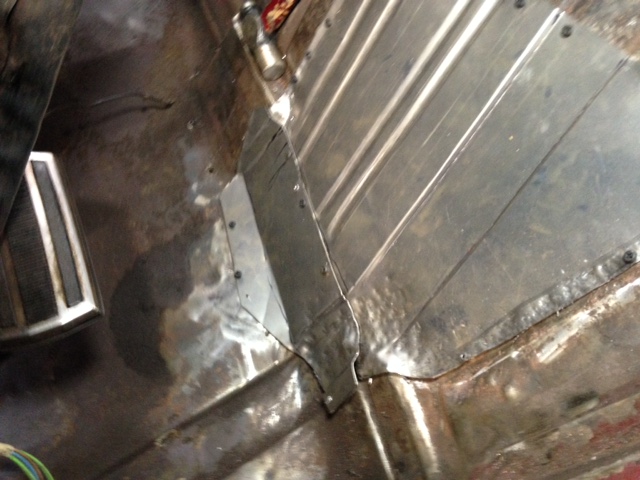

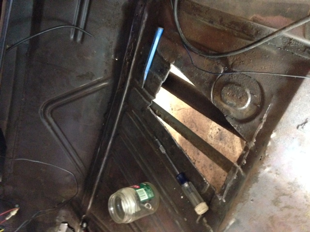

Decided to do it my self. Don't know alot about doing this job but I've done the forming with a ball peen hammer which is not pretty but will be covered by carpet. did the channels with a bead roller. Screws are for place holding - I'll plug weld each screw hole and stitch the edges in to the pan - i'm worried about blowing though on that step, but hopefully patience and luck will carry the day. Any suggestions on forming the pans welcomed.
Cheers
