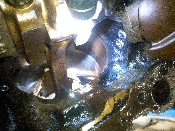

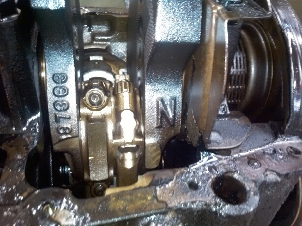

A couple of years ago I nabbed a 455 out of a 68 Toro from a wrecking yard in Monterey CA that turns over like butter, I was going to use this in my 442 but I`ve since found a 67 442 block so this weekend I pulled it out and removed the pan to find out it`s beautiful inside, very visible hone marks on shinny cylinder walls and a Nodular crank :D .
I`ll be doing a comp test this week and if that turns out ok I`ll move forward .

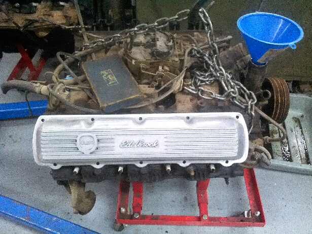

Postby jabberwoki » Sat Oct 01, 2016 8:17 pm
Found some Bling in the attic. I`ll be priming it and comp testing it on Monday.
