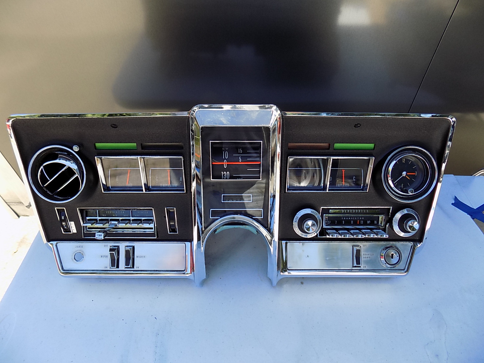

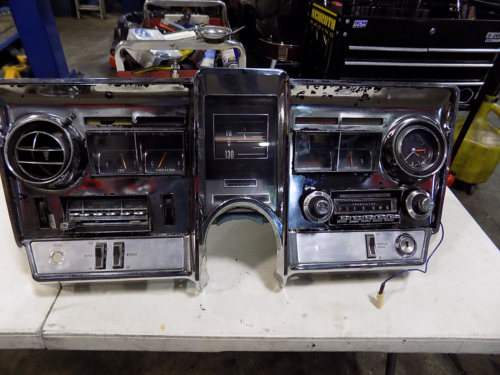

Re: Remove Dash Cluster
I restored the cluster on my '66 this past spring. Removal is pretty straightforward. Lower the steering column- two nuts on studs. Be careful not to overtighten on the reassembly- one of mine snapped on me and I had to drill it out and replace. I think they might be shear bolts, because it snapped without much pressure at all.
If I can be of any assistance, please let me know. I took a fair amount of photos. Before and after below.
What did you use for the green lenses over the turn signal indicator lamps?
I think it's pretty straightforward, but heavy and awkward. An extra set of hands would be useful in my view. Also, that is a good time to replace ducting for the vents which usually goes bad. Check out all wiring connections as others have mentioned earlier. I used some green plastic file folder materials for the turn signal lenses which have no markings on them (arrows). THankfully, the other lights with lettering (Brake -red and Hi Beam - violet) were in good shape, so they were re-used. I would include a picture of mine, but this site is a hassle regarding picture sizes. I used crinkle paint from Eastwood to redo the dash paint. My car has been a complete restoration project. Getting close to upholstery only to finish it up. A few mechanicals to yet be gone through.
