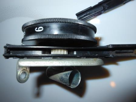

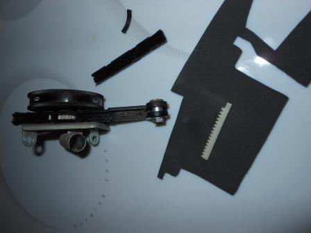

I'm looking for a unit off a parts car. Mine is broken. The sawtooth that controls the cable movement to the cruise control is a plastic piece which can easily break after the plastic become brittle. I've included some pictures here. They are pretty simple. If I can get a good unit, I may try to reproduce these plastic pieces if there's any interest. See picture descriptions for more info.
Speed Control 1.jpg (77.09 KiB) Viewed 5855 times
I put the broken white plastic sawtooth on a black background for easier viewing. The end is broken and that is what connects it to the cable going out to the cruise control unit. The cable just has a 90 degree bend in the wire which likely sits in a groove/hole that broke off the end of this piece. Here you see the dial assembly (as you rotate dial, it operates sawtooth back and forth which in turn operates the cable back and forth). There is a small spring that sits on top of sawtooth between lid to give tension. The lid was pried off. It was "heat sealed" melting the plastic together in several spots to create the sealed unit.
