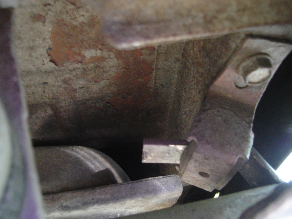

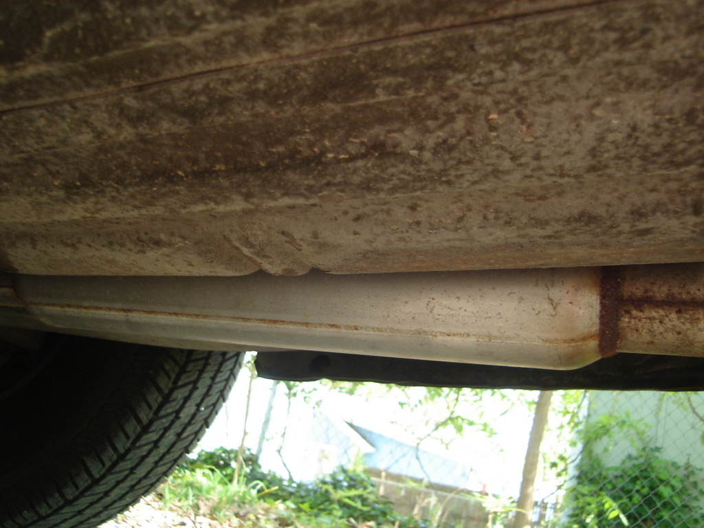

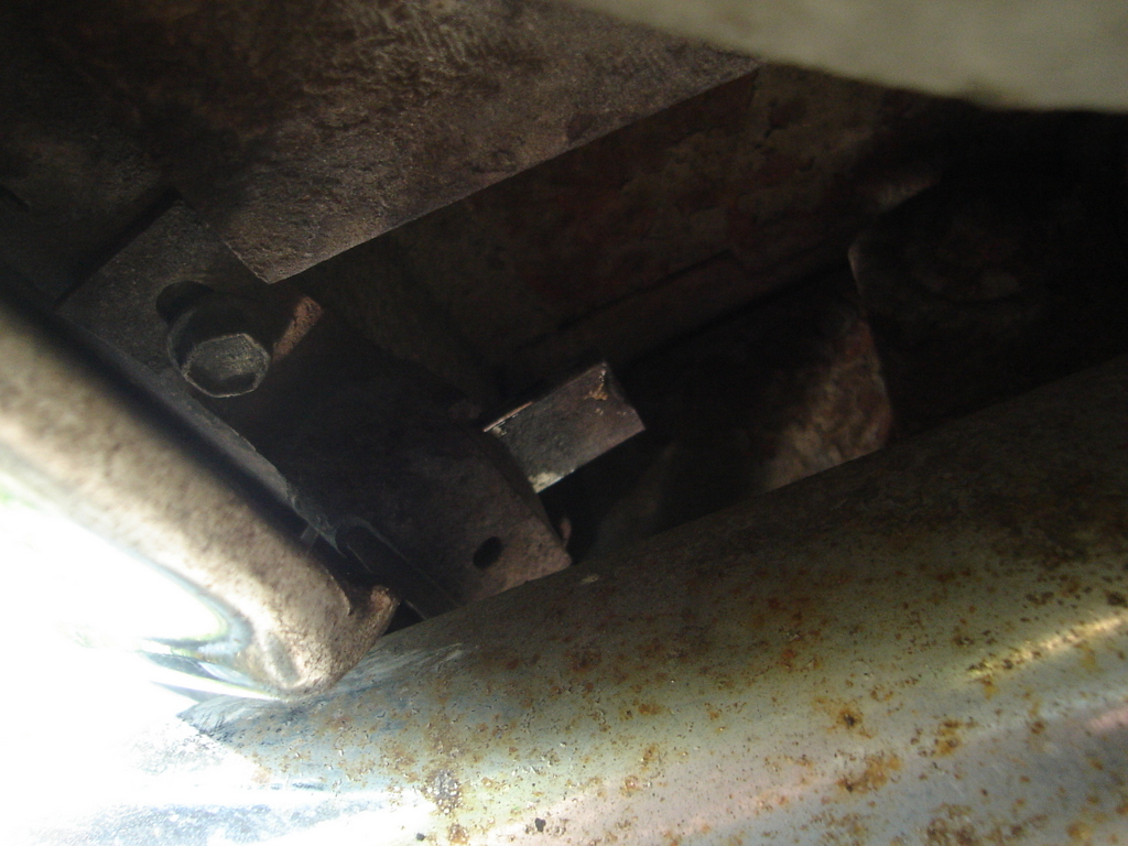

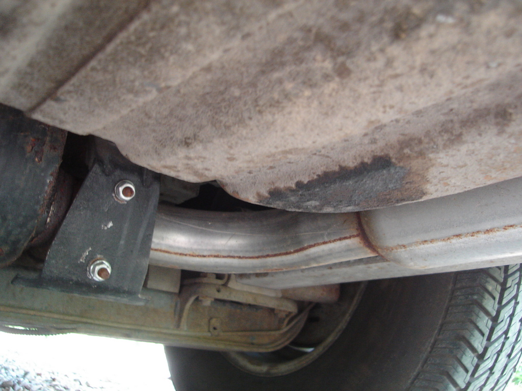

Here are some pics. Note the rubber insulators that the hooks on the chrome tips slide into.
Are your insulators missing?
Also note the the tailpipe/resonator pipe inside the chrome extension in the first photo.
(Boy those tips look like shit up close. They look really good on the car and you can't even see the pitting and rust). Now that's going to bug me.
- DSC04043.JPG (367.18 KiB) Viewed 27484 times
- DSC04044.JPG (374.38 KiB) Viewed 27484 times
- DSC04042.JPG (389.9 KiB) Viewed 27484 times

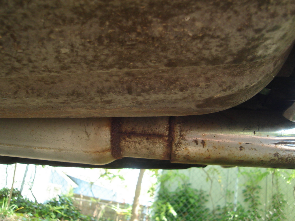

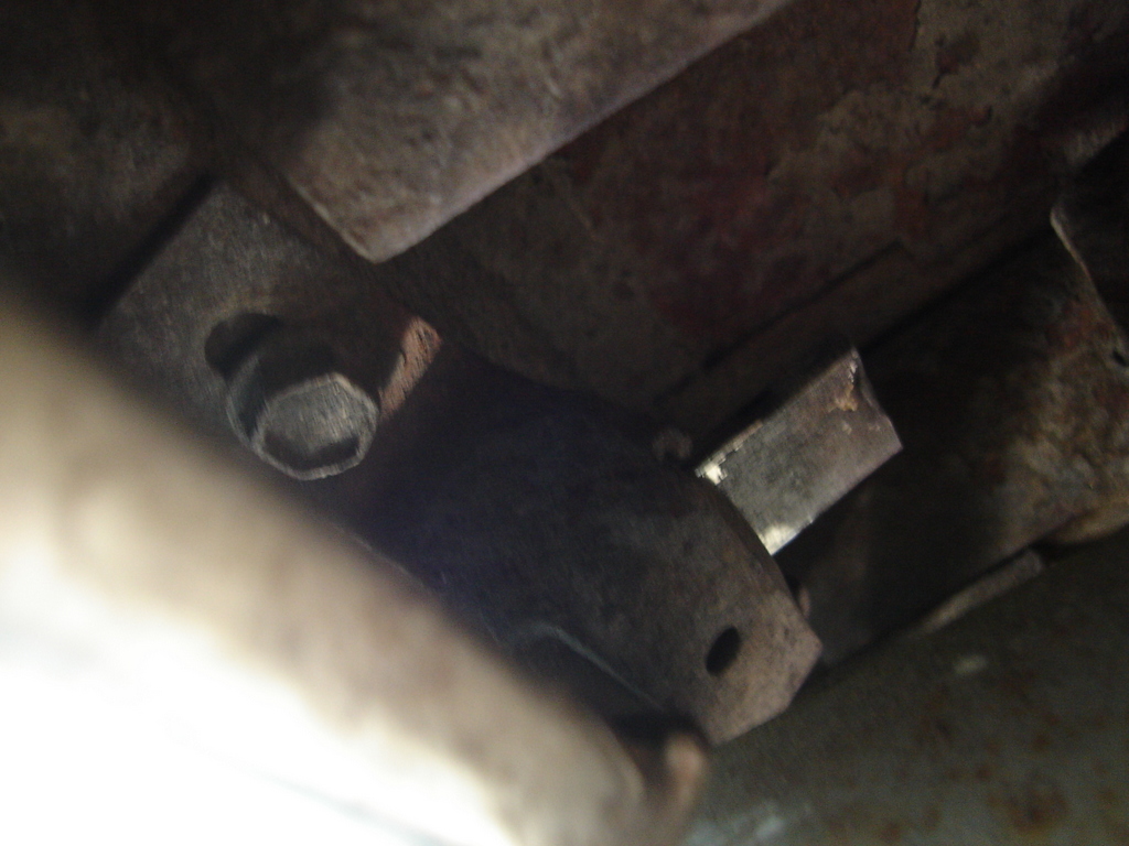

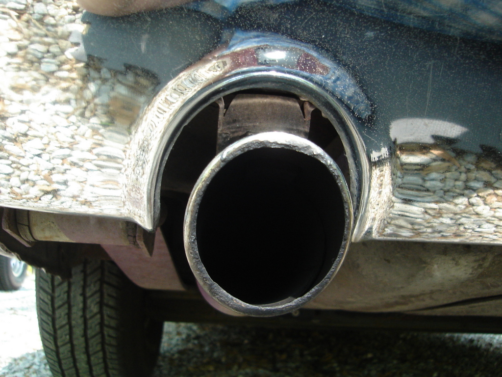

Here are some shots of the extension attached to its insulator.
The first photo has the back of the car to the right. In the other two, the back of the car is to the left.
- DSC04050.JPG (358.07 KiB) Viewed 27484 times
- DSC04046.JPG (336.58 KiB) Viewed 27484 times
- DSC04045.JPG (390.17 KiB) Viewed 27484 times

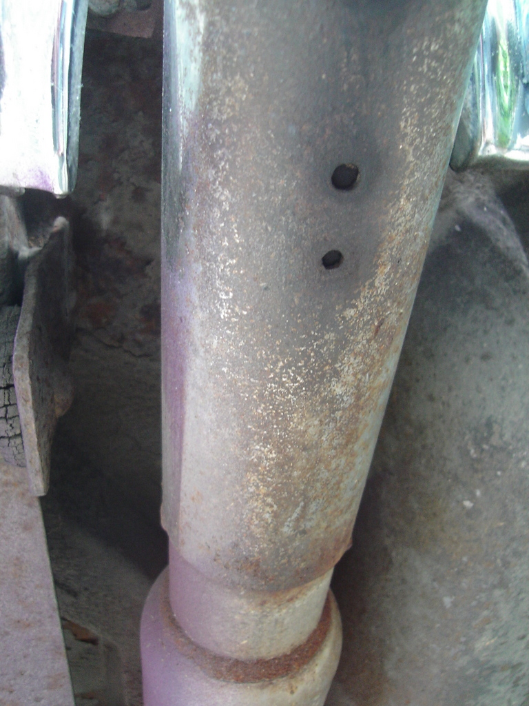

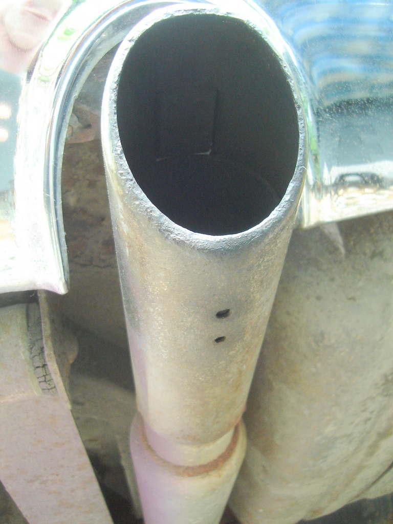

Here are some more pictures. I don't know if they advance the cause but I took 'em so I'm postin' 'em!

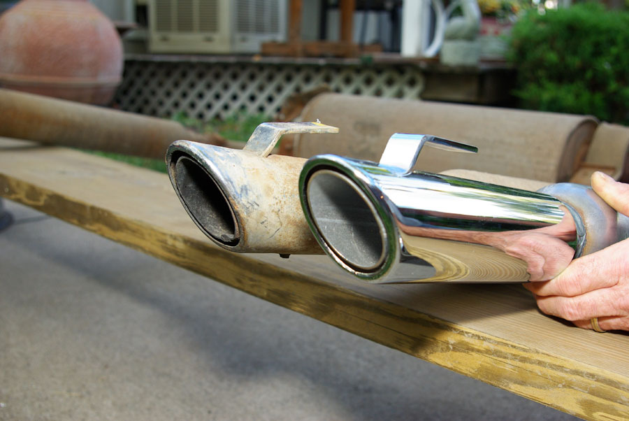

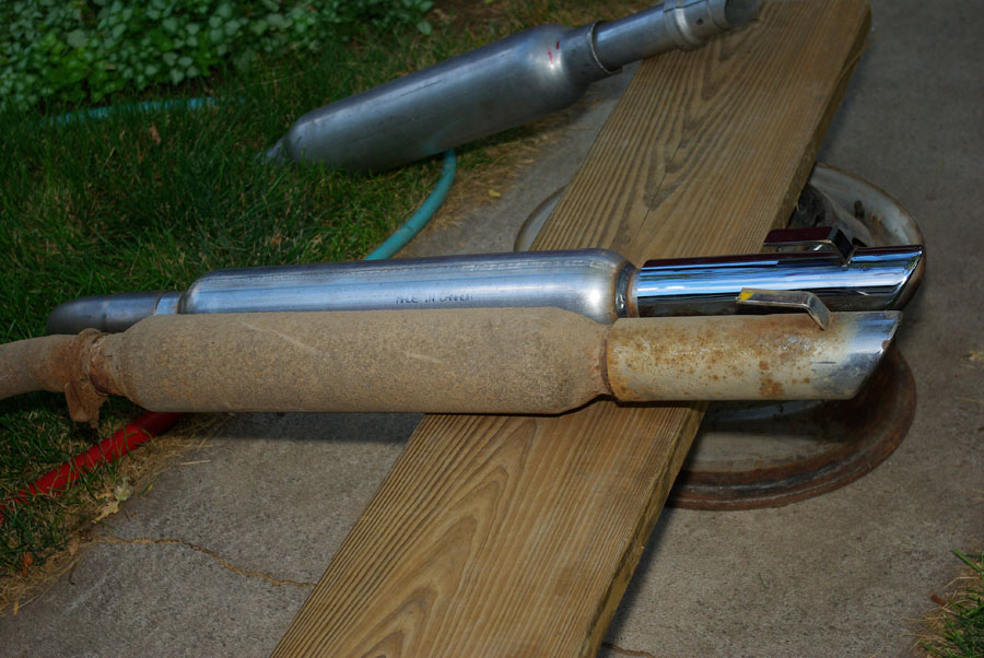

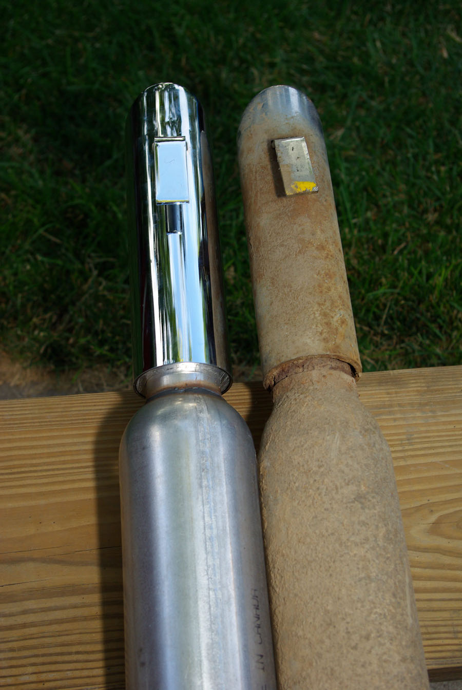

okay here's the lowdown on the chrome tips. First they were never designed to carry exhaust below is a photo if a NOS resonator. The cost of reproducing the original is through the roof, mainly as individuals are doing them for them just for selves and not mass producing them.
Shown are repo that I have developed with an (NOS in the back ground) they are not prefect, they do however properly aline/position and secure the chrome tip to the resonator (all at a reasonable cost there are number of them out there) one could do and have done a lot worse but as with anything its judgment call.
I should note that I am working on a direct replacement and current sales are funding that endeavor.
- IMGP0032_L132.JPG (153.67 KiB) Viewed 27463 times
- IMGP0034_L134.JPG (183.52 KiB) Viewed 27463 times
- IMGP0022_L122.JPG (121.71 KiB) Viewed 27463 times
