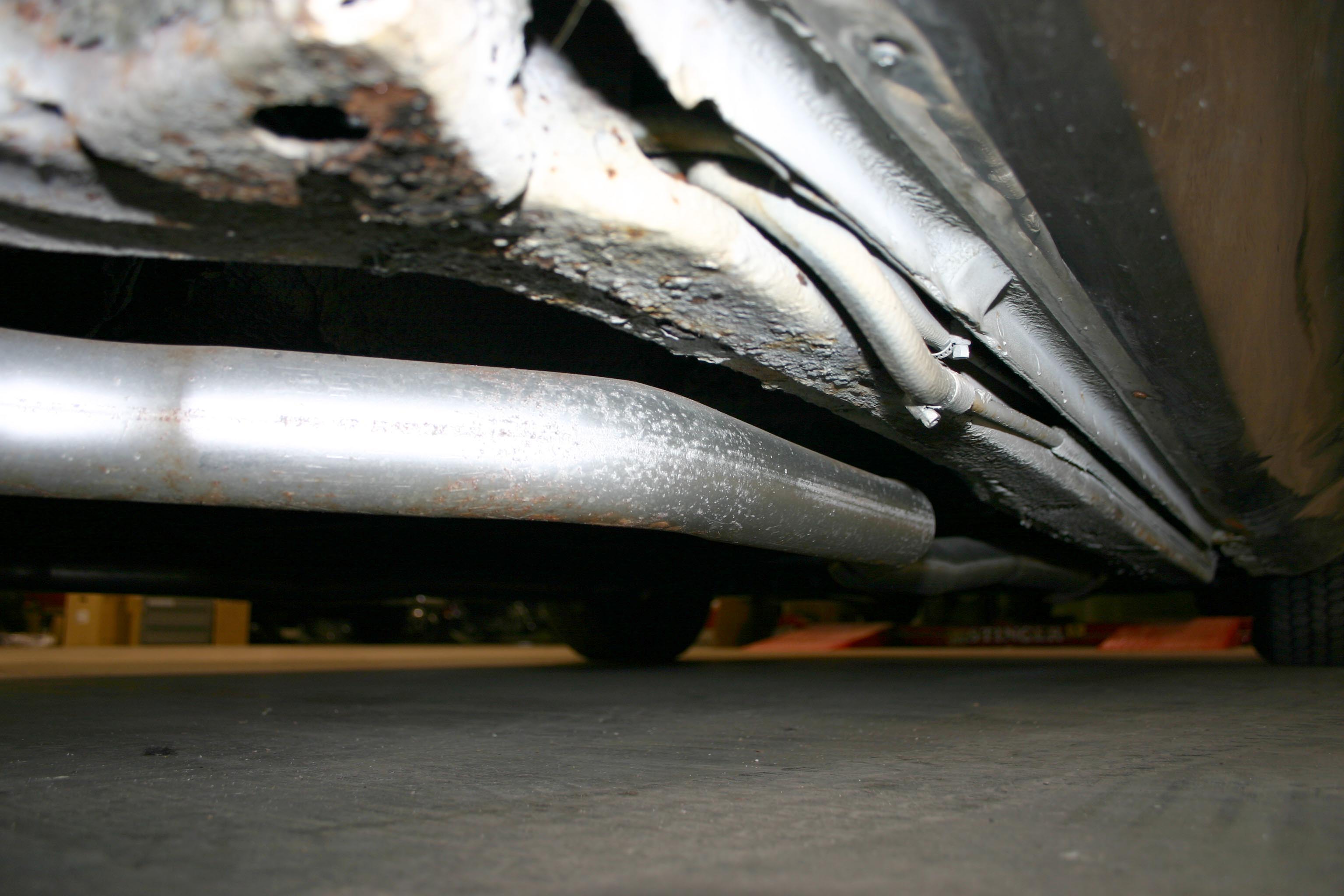

here is picture of the steel line running along the frame diving off in the sub frame headed to the tank .........
followed by a shot of the where they come out of the sub frame .... sorry for the LARGE pictures

Awsome Bill, Thank you! So is the last pic showing the fuel tank attachment bolt or body bolt? I see now how the fuel tank needs to be dropped, but is it going to be necessary to raise the body?
Re: Fuel line access,Is there is an inline fuel filter on th
That bolt that is hanging down is the tank strap bolt. You can miss the body bolts thay are just inside the of the forward spring perch recessed washer with bolt & rubber isolator, don't worry about raising up the body, but just do enough to provide access the clamps if you go to much you risk tweaking something it can stand and inch or so just use good judgment. One more thing should the not want brake loose don't fight it or risk twisting them off ... sorry just can't say enough about exercising caution.
