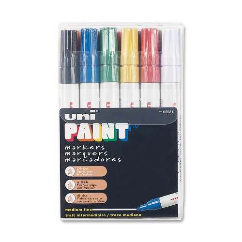

Postby Doc Hubler » Sat Feb 15, 2014 12:12 am
They told me Fuggetaboutit. They dont' sell it. I looked all over and thought I could get it from the Corvette guys, but that was a bust as well. They probably hoard what there is amongst themselves. I went to NAPA and bought a spool of the black vacuum tubing (couple sizes needed), and I have markers that I've purchased to paint the stripes on. It will work well I think! The red and white stripes were actually co-extruded rubber with the black portion of the tube on the originals, but the rest were painted anyway. I don't know exactly how much it will take, but I will try to make notes on it as I go to replace them one by one. I can get you the name of the markers I am using. I bought a set of several colors on Amazon.

Postby ydennekkram » Sat Feb 15, 2014 6:58 am
Thanks for the update. Any info you can give me on the size, length, color, pens ..... anything at all. Thanks for the info on your exhaust as well, I did see the set up on FB. Cheers!
