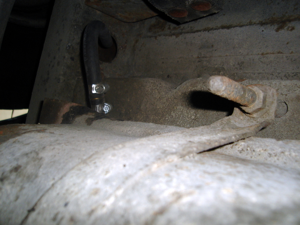

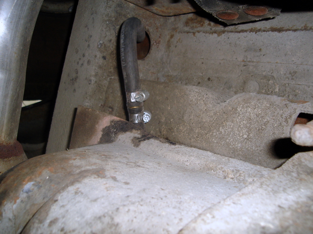

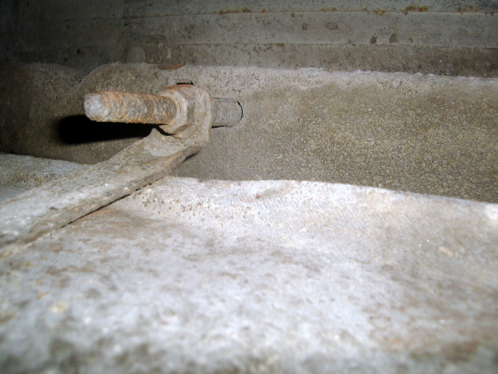

The next four pics show the long bolts that hold the straps at the front of the tank. As they are released, the straps will act sort of like a hinge and lower the tank at the front , pivoting at the rear where the straps hook into the slots.
The front of the car is at the top of the photos

Notice the position of the fuel line and don't forget the ground wire connection by my finger.
Scrape off the undercoating if you can. Hopefully you don't have a lot of rust. If you do, soak the daylights out of the threaded rod and nuts with penetrating oil. The best stuff is a home brew of 50/50 transmission fluid and Acetone. Put it in a little can and paint it in there with a toothbrush or put it in an old Windex bottle
