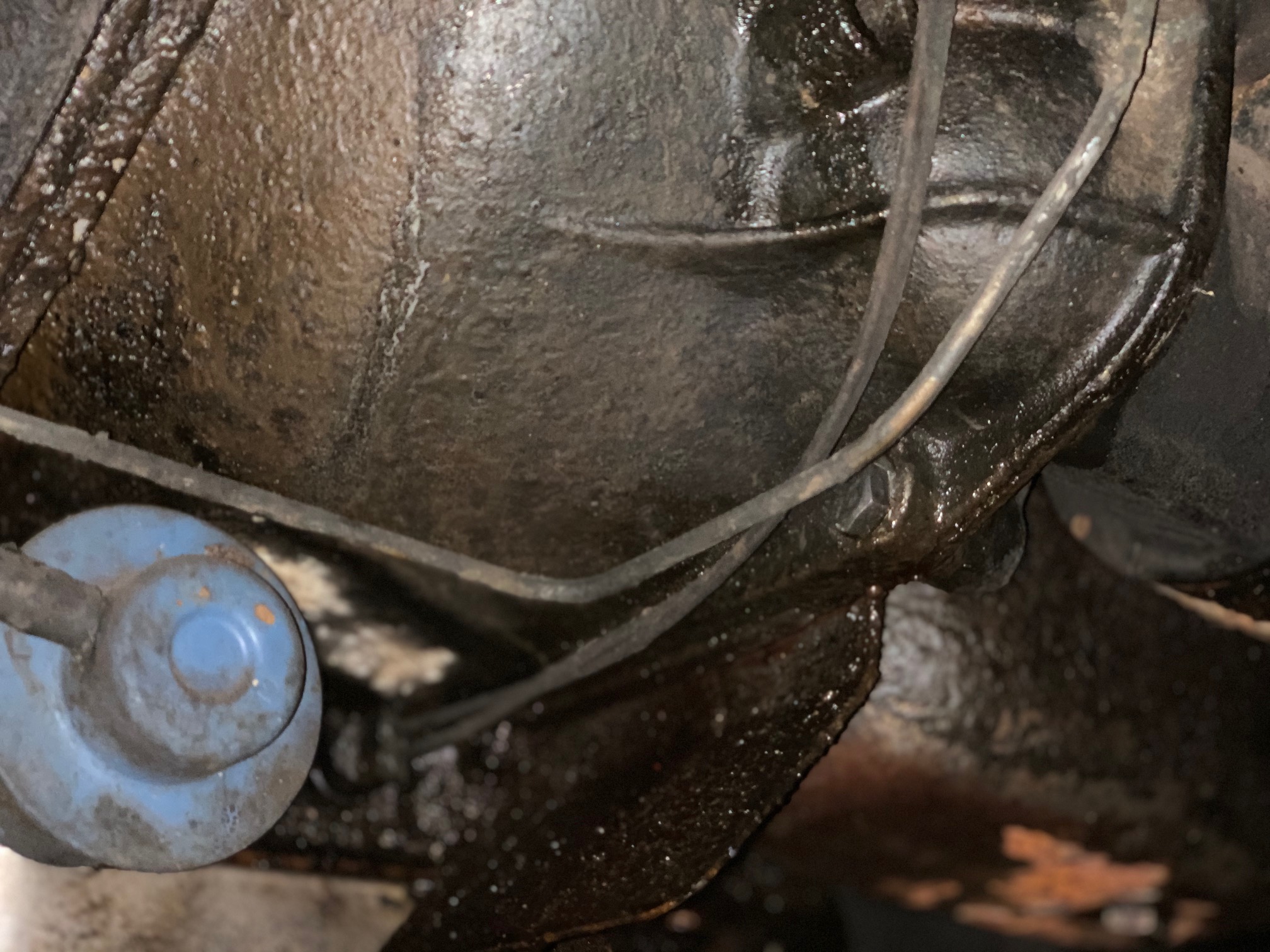

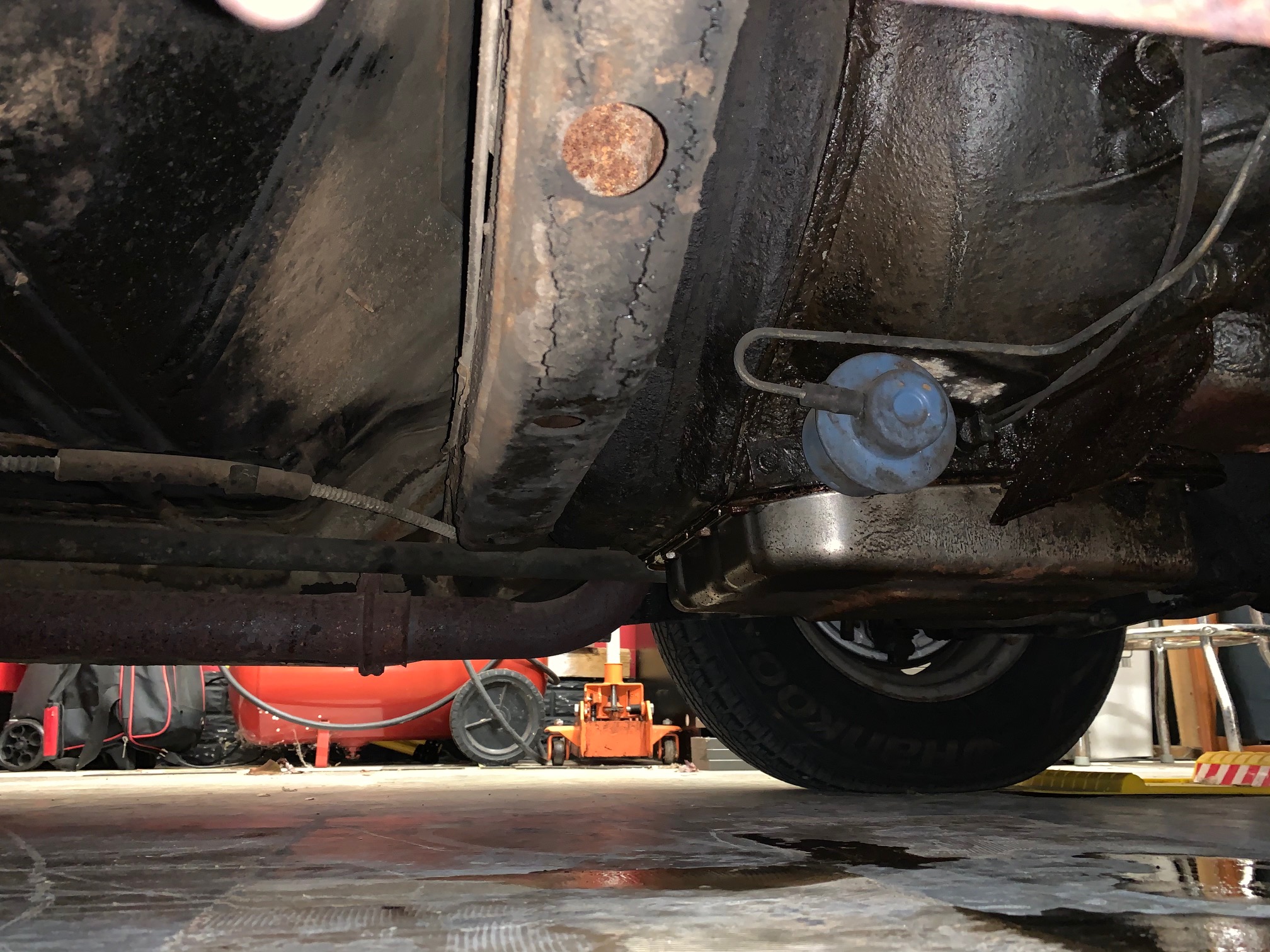

I know this is an old post but running into a similar issue. I just got my '67 Toro up and running after sitting for 25 years. I've been driving it for a couple hundred mile so far and now I'm getting a transmission leak. Looks like it's mostly dripping off the little air deflector that's under there. I haven't had a chance to get it up in the air yet to really dig into it, but is there a gasket in that general area that is a likely culprit?

Otto Skorzeny wrote:I'm not sure what you mean by deflector. Are you talking about the plastic splash guards or some part of the transmission?
It's kind of in the center of the first photo, off to the right in the second photo.

Re: Transmission leak 1966 Toronado
Muddy4DSM wrote:So use the glue/liquid gasket, how hard is it to remove the cover to get that glue on? Do you have to drop part of the transmission or can you remove the cover from just getting underneath the car?
It is generally done with the trans tipped forward, so the chain cover is
on top. Use plenty of glue, some inside will do no damage. Easy if the
trans is getting the needed refresh (maybe not a full rebuild) at this age.
I doubt it can be done in the car, certainly not mine, check yours. Bruce Roe
