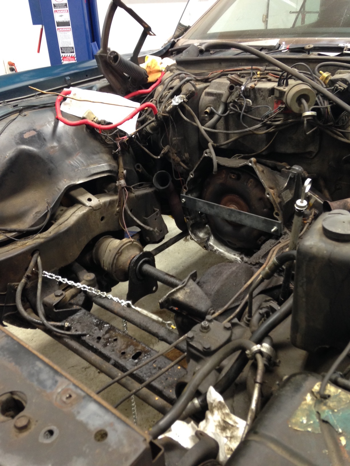

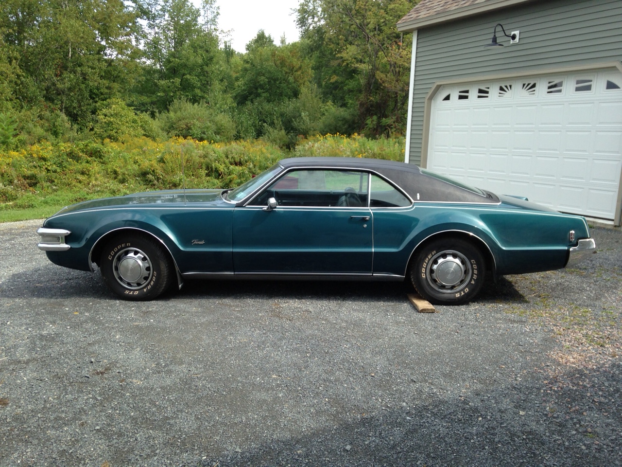

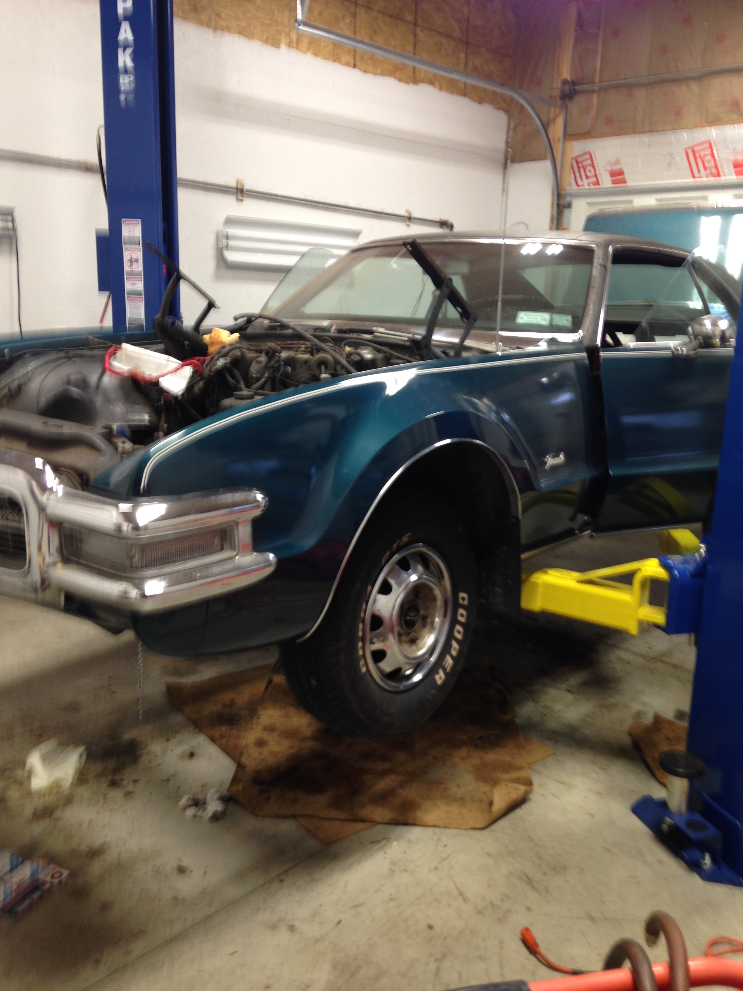

Here's the rig. some of the floor work done. and, I think with the motor out for some top end work. wish i would have changed out the timing chain while I had the motor out - don't know what i was thinking.

That's nice. Nice color. I can just make out the rag joint but not well enough to see if it has any visible damage.
