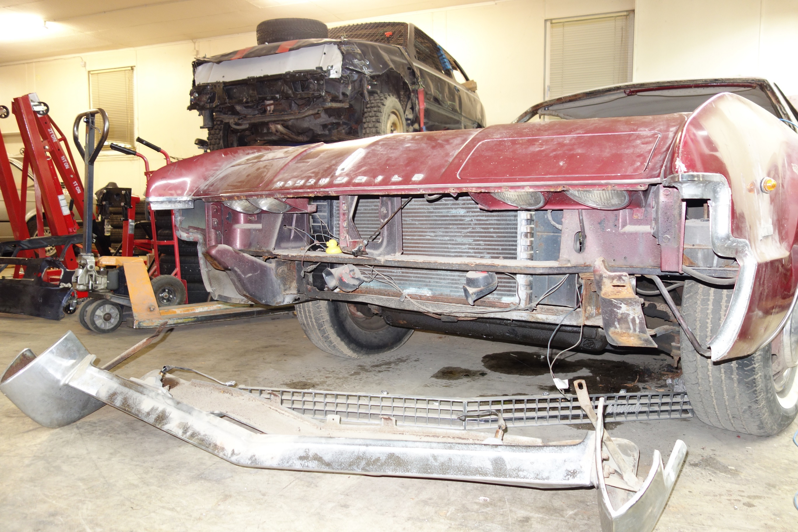

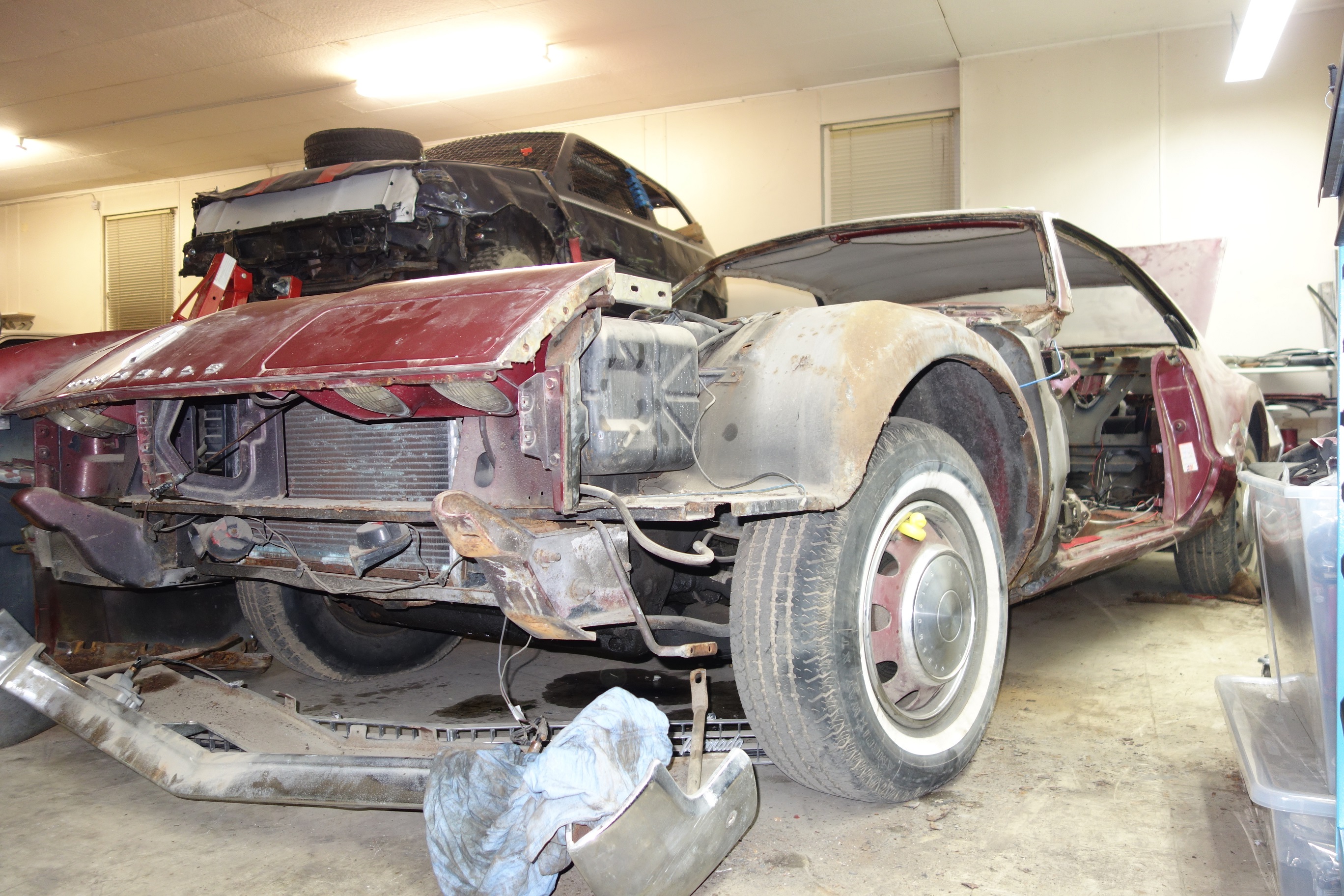

Good afternoon,
I have a 67 Toro and I presume the system didn´t change in this area.
I cannot remember all the steps I took but I can provide you with some pictures of my disassembly. maybe you can figure it our with those.
Regards
Claas
the vacuum box for the front lights is fixed through the fender.

Postby Claas » Sun Aug 13, 2017 9:15 am
If you cannot find the needed information in these I can go back to take some more detailed pictures. Just give me a note which area you need to see.

Sorry I haven't checked here lately as I figured out how to remove the bumper and nose section. The bumper was not too bad, just six bolts, three on each side. The nose section was a little trickier as you have to disconnect the actuators. The other key is that you have to unbolt the headlight assemblies as well. But thank you for the replies and photos!
