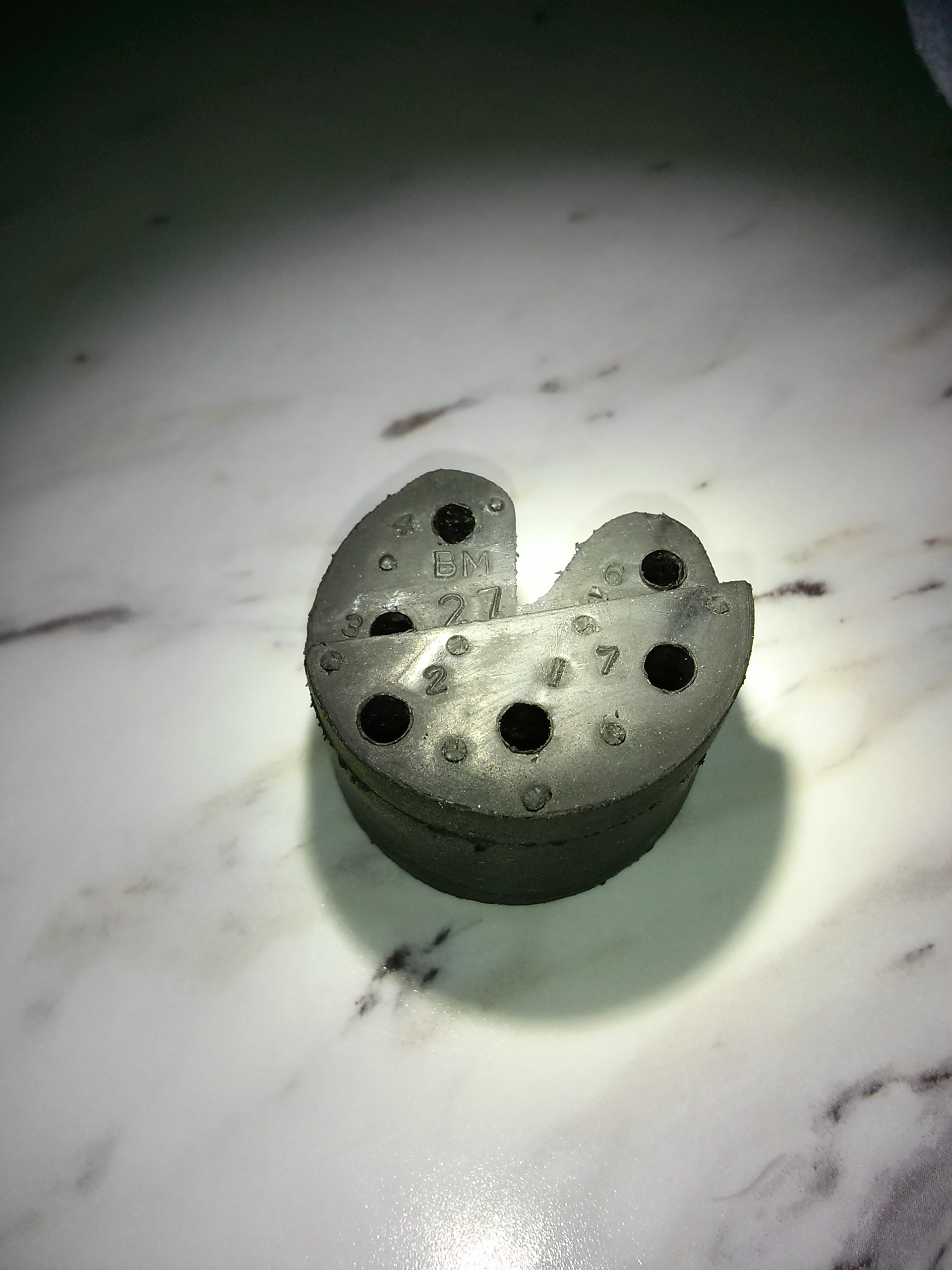

Hi guys
I'm working on my dash cluster.............Does anybody have a diagram of the vacuum connections on the side of the heater/ac control unit.
I know they are numbered but I can't read them. Their is 5 ports on that round piece where the vac lines plug in.
Oh this is a 1966 toro.
Thanks
19toro66

Yellow-1, White-2, Blue-3, Orange-4, Purple-6 and Red-7.

Re: heater vac controls
Postby 19toro66 » Fri Jan 27, 2017 7:10 am
Let me know if this helps. If not, I have a diagram for 67'.

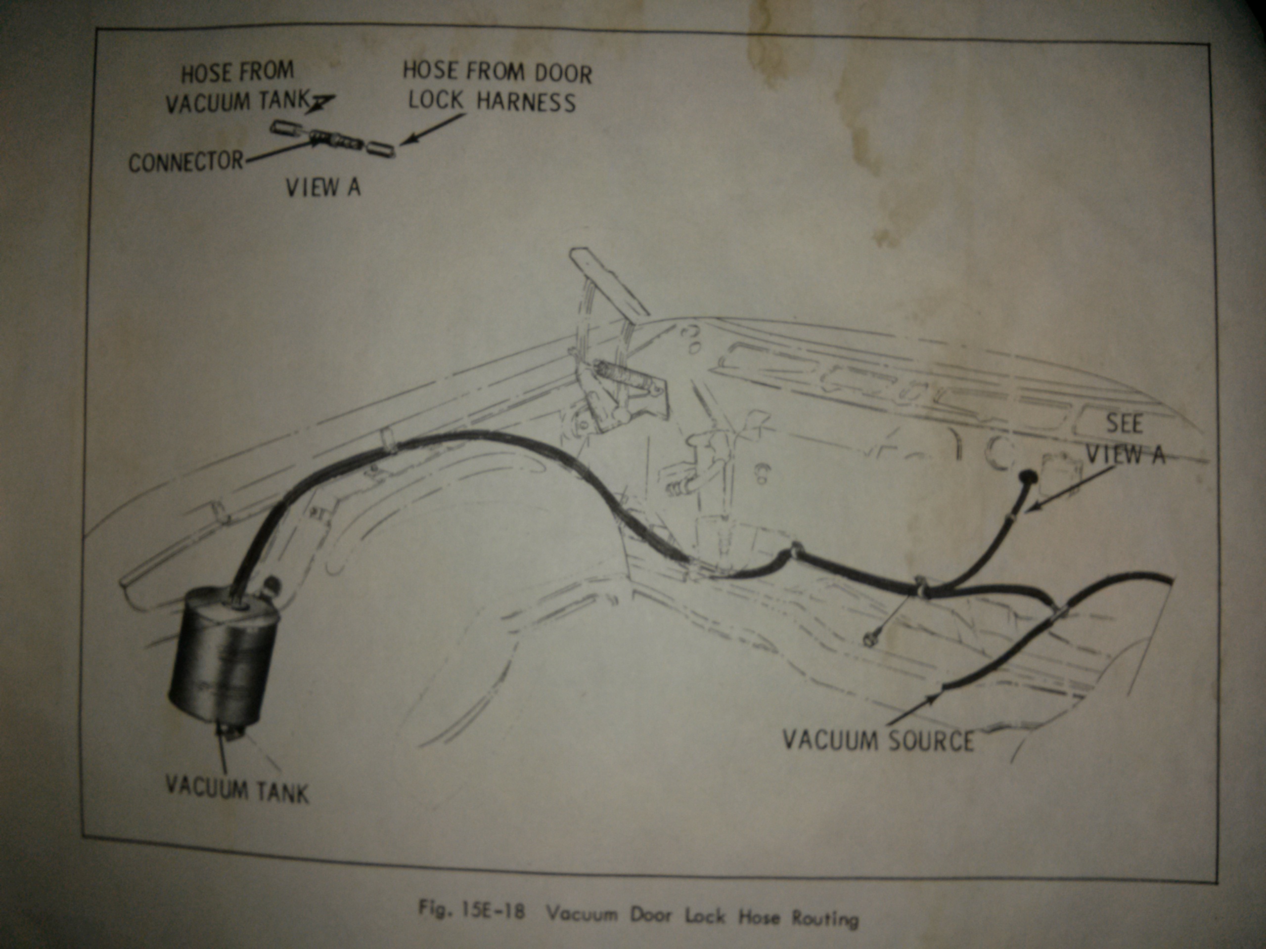

Hello
19toro66
Would diagram for vacuum door locks
Postby 19toro66 » Fri Jan 27, 2017 3:29 pm
This is what the Chassis Service Manual has.
Postby Toronadotrofeo » Fri Jan 27, 2017 3:43 pm
Thank you 19toro66
