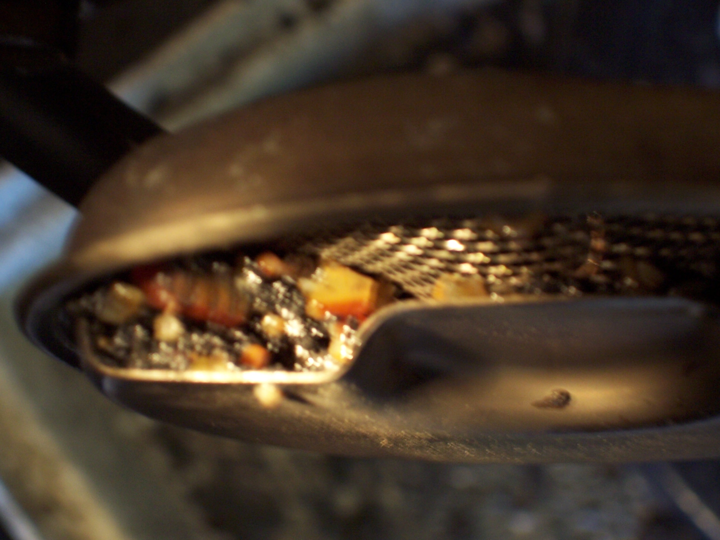

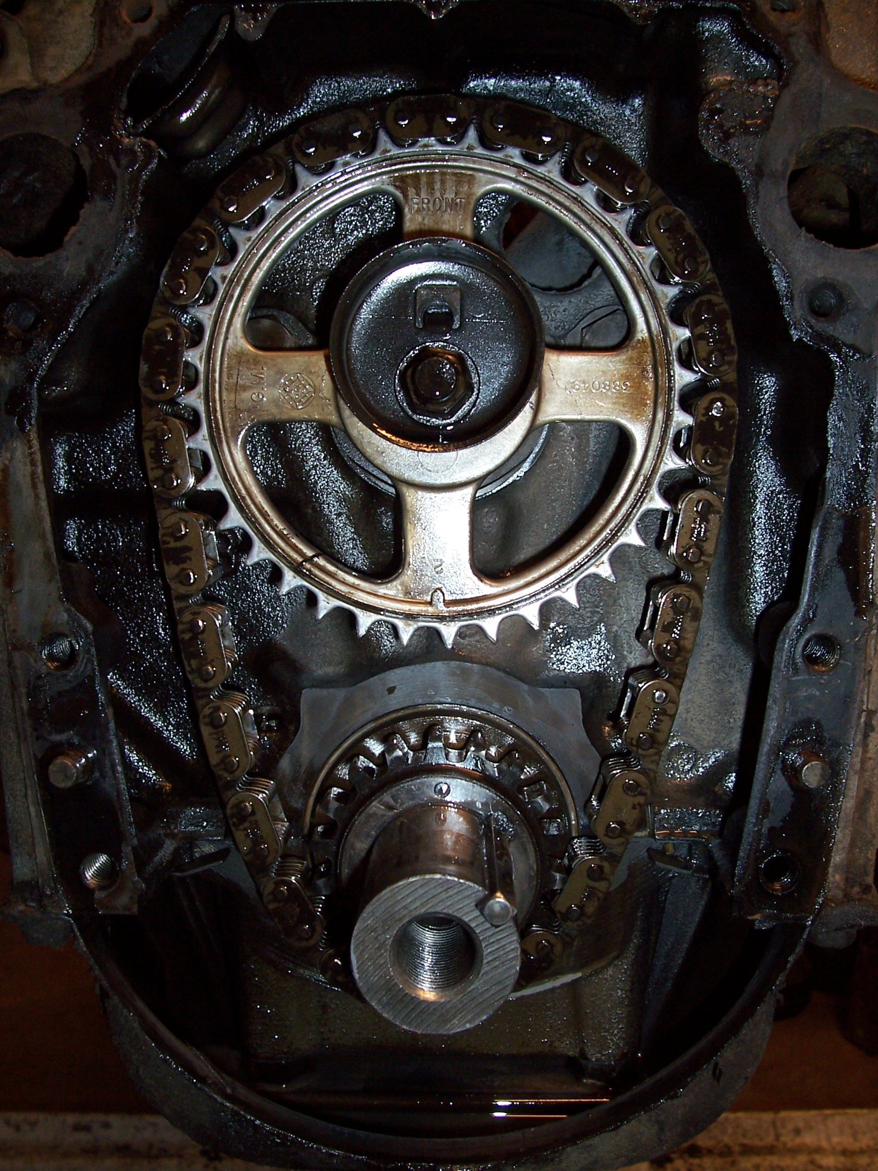

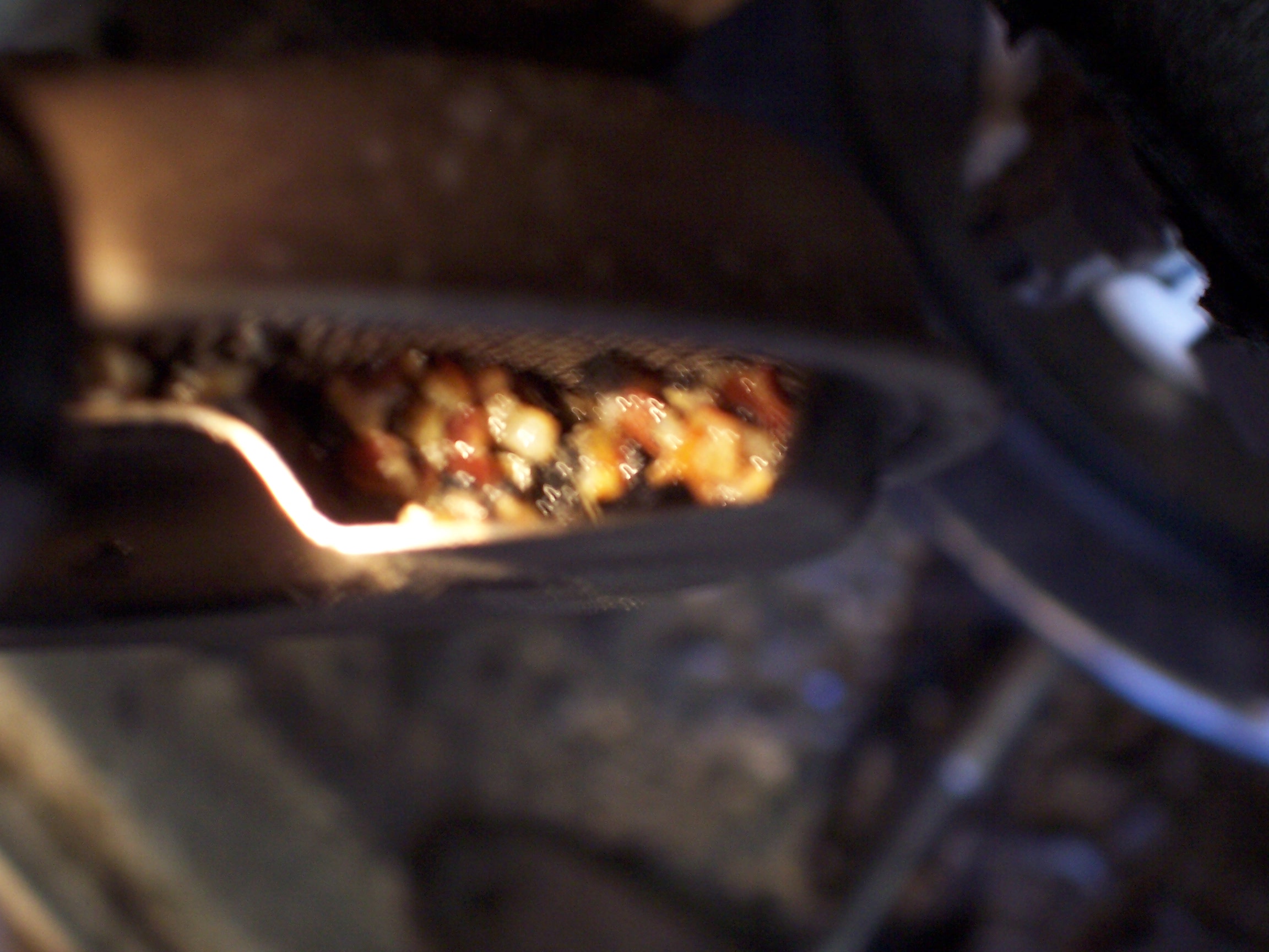

Re: Possible LOW Oil Pressure Problem
Filters and sending units aside how long have you had the car! Has the timing chain / gears been changed?  In doing so was the pan and in particular the strainer cleaned out?
Here are photos of cam sprocket and where the plastic ended up! Sorry about the size but you get the idea.
69W34 wrote:Filters and sending units aside how long have you had the car! Has the timing chain / gears been changed? In doing so was the pan and in particular the strainer cleaned out?
Any V8 Toro needs a new timing chain set by now, those pictures are pretty typical. Yes
it could be a plugged oil pickup, and that will be most damaging at higher rpm. Change
the chain, if the plastic is in the pan, pull it it & clean it up. It will be easy to add a
high volume pump at that point.
My favorite Olds engine (403 Toro) idles at 40 psi. Turning on the oil light IS BAD!
Bruce Roe
