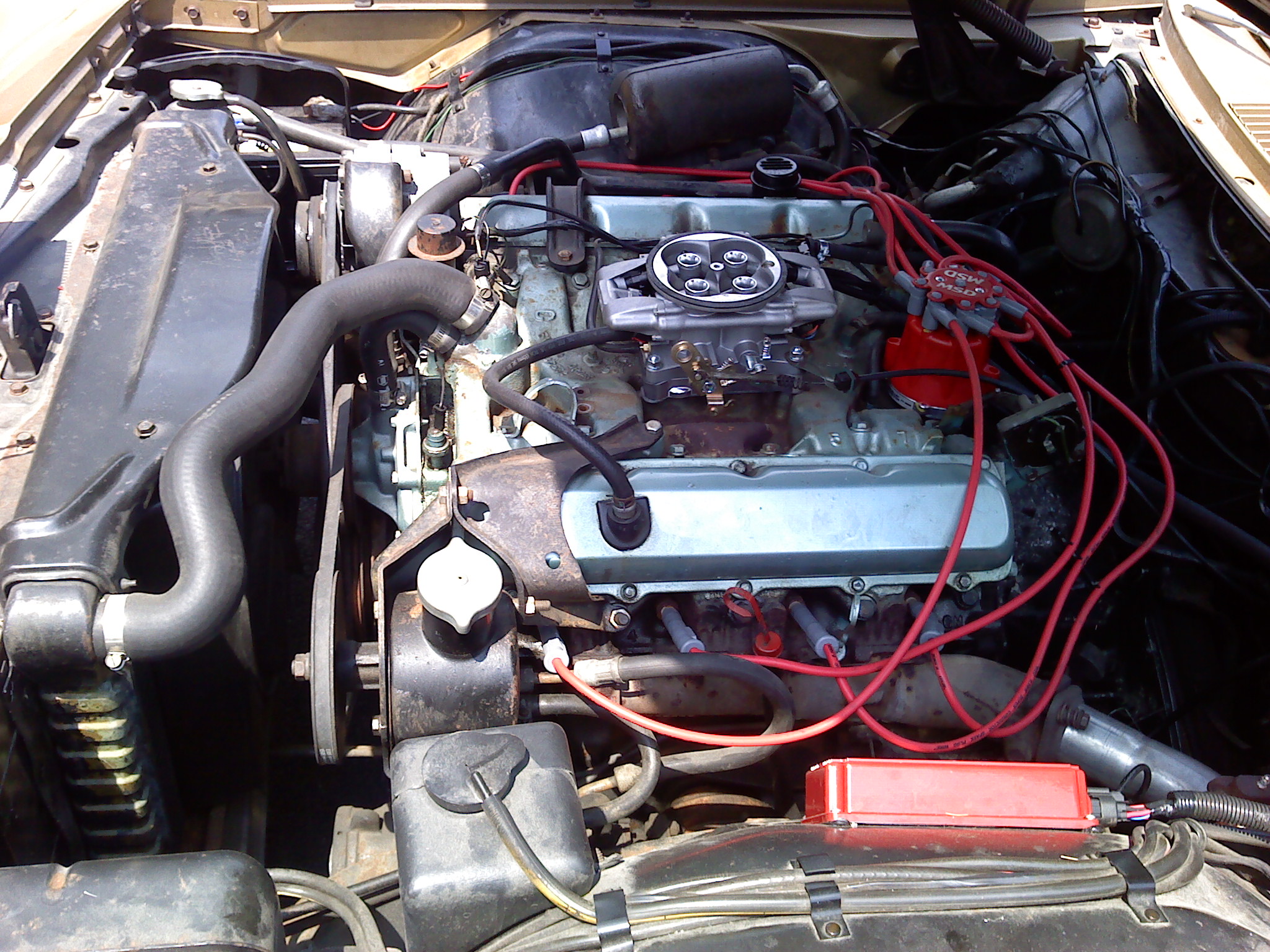

The motor was apart when i got the car.
I believe the harmonic balancer is original, but the water pump does not line up with either of the balancer pulleys.
Which groove should the belt for the pump ride in?
Do you have photos of your setup?

Postby 762 » Wed Oct 15, 2014 11:00 am
Not sure if it's going to help, but I could only find one picture that showed my water pump without it being obscured by the alternator or power steering res. I can go take some better pics tonight

Postby bluecab » Fri Oct 17, 2014 5:47 am
might be an optical illusion, but that pump looks a LOT shorter!
Maybe I've been trying to put the pulley on backwards..
