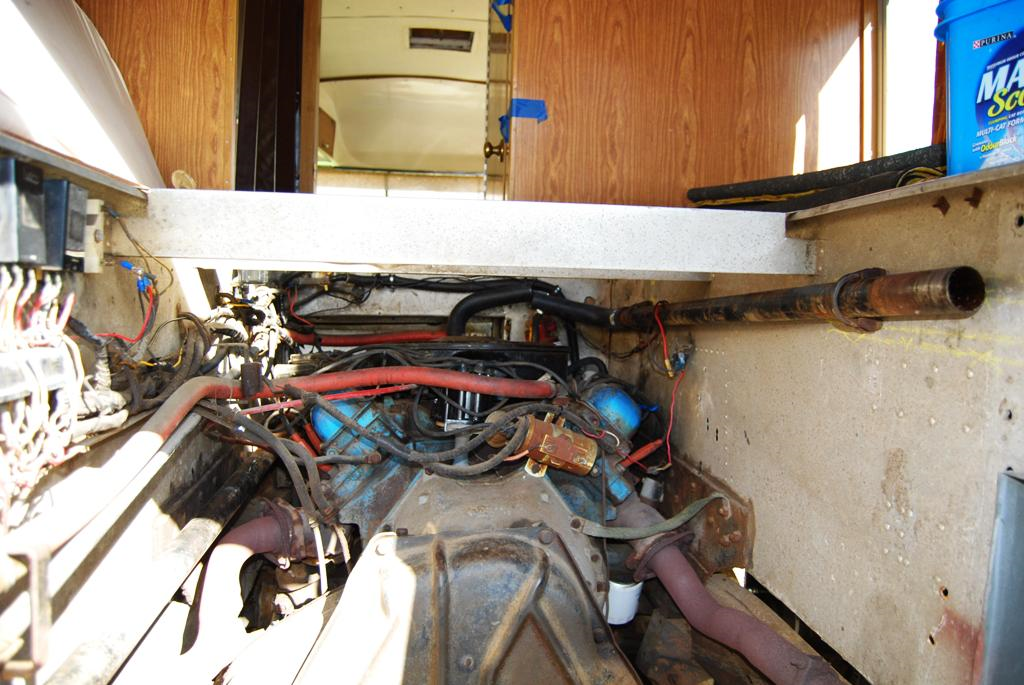

Thanks for the info.. I need to decide just how small I'm willing to go in tire diameter and I had to be sure I was using the correct factory tire size to begin with.
If my calculations are correct I will end up about 300 to 400rpms higher at 70mph...
Thank you again.
