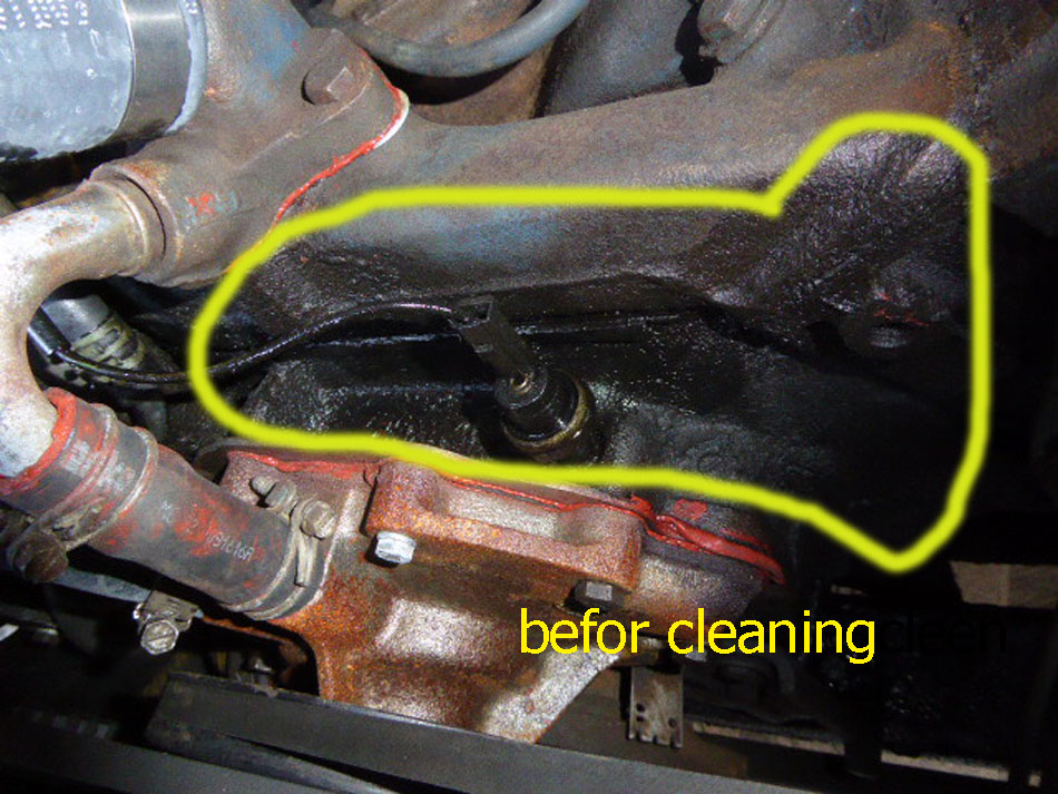

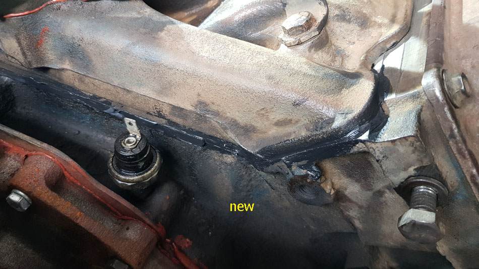

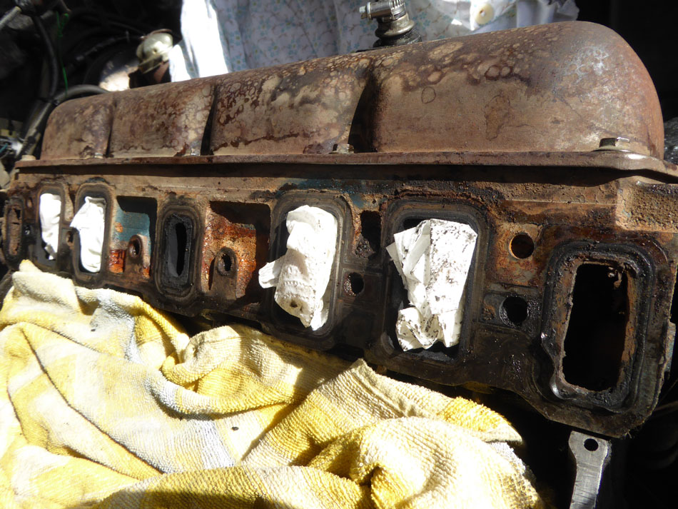

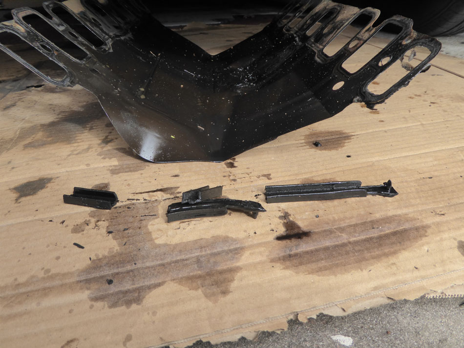

Re: Hello from Germany!
Postby Jelonek » Fri Apr 03, 2020 2:42 am
no... nothing bad but I had a problem withe the intake-gasket at the front , lekage, leaking,
last summer a got a new gasket and the work ist not so complicated, even ignition don´t musst be disassembled,
the Intake is a very heavy, so I built a pulley to put it with feeling ...
so today i want to refill the coolingsystem and drive again :roll:
Jelonek
Posts: 152
Years Owned: 1
Postby Jelonek » Fri Apr 03, 2020 2:51 am
some pics after the work
