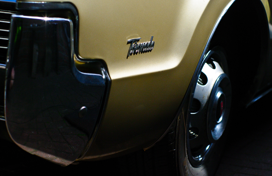

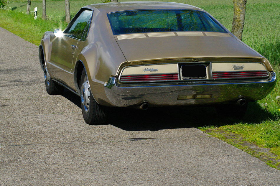

Hallo Guys,
Bruce thanks for your mail !! very interesting, I think so long so good I wait with this idea...
so... carburetor works perfect!, powerfull and I can set everything by myself,
the car is prepared for the summertime
later I want to check my wheel bearing, but now is to cold for that
I took some pictures today...
