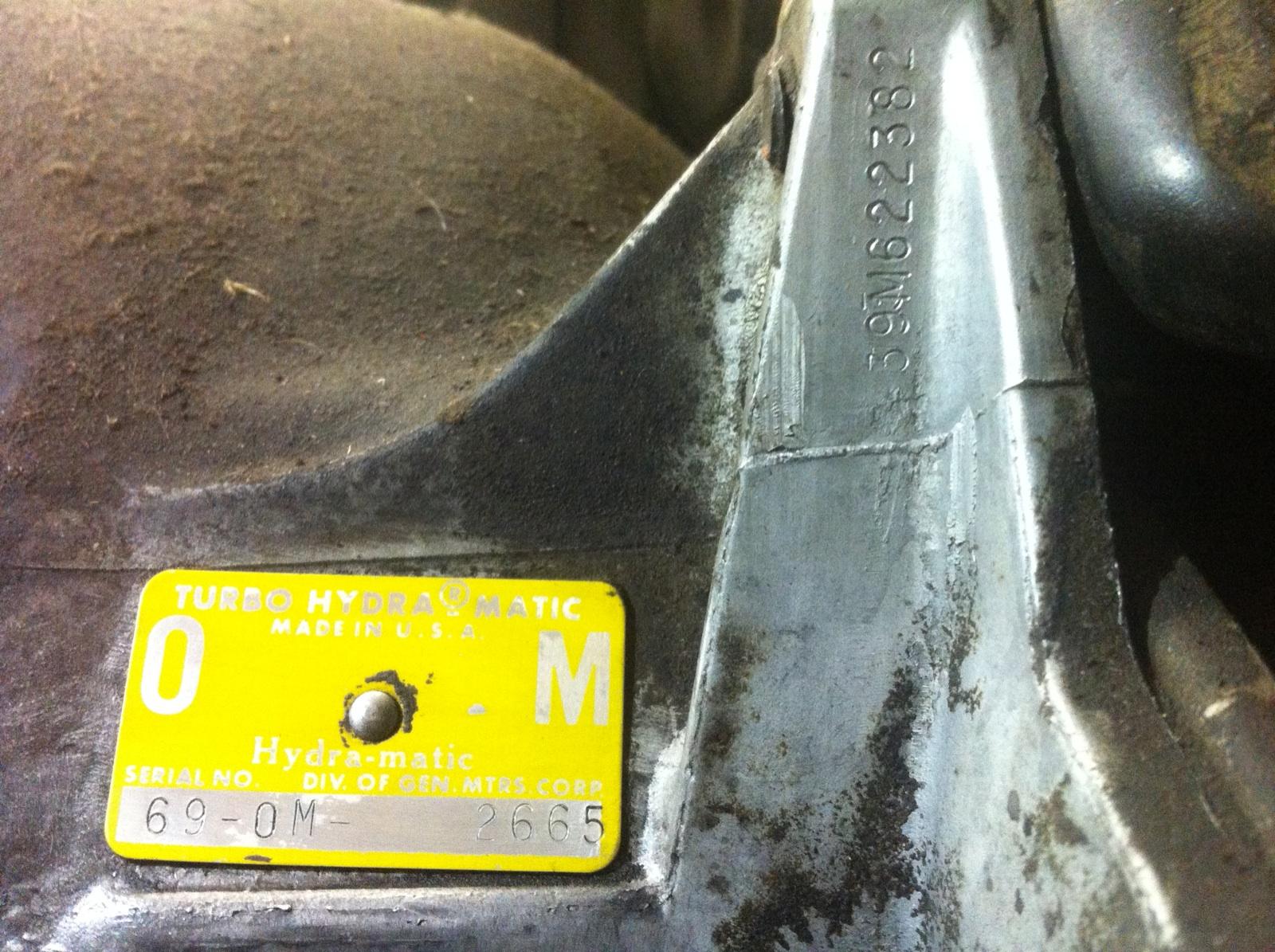

The shop here is restoring a 1969 W-34 along with my 67 Toro. THe W-34 engines had a special cam and hardened valve springs. THe transmission was also heavy duty, and was an "OM" transmission tag. Your's is probably the standard transmission for these cars which is "OJ" code. YOu can check those numbers they should all match with the block as well.

Must find the OJ or the "OM" transmission tag code you mention but where must I start to look for this code

Here is a picture of a W-34 Transmission (OM) on a 1969 Toronado. The matching serial number is also stamped into the aluminum trans case. Your trans is almost certainly an OJ (standard 425 Turbohydramatic AT).
