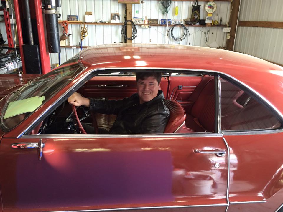

Is that Autumn Mist, Autumn Rust or whatever they called it? What's that purple square on the side of it in the first photo?

Otto Skorzeny wrote:Is that Autumn Mist, Autumn Rust or whatever they called it? What's that purple square on the side of it in the first photo?
It's Autumn Bronze.
The purple square is a reflection of a blue toolbox in the door.
