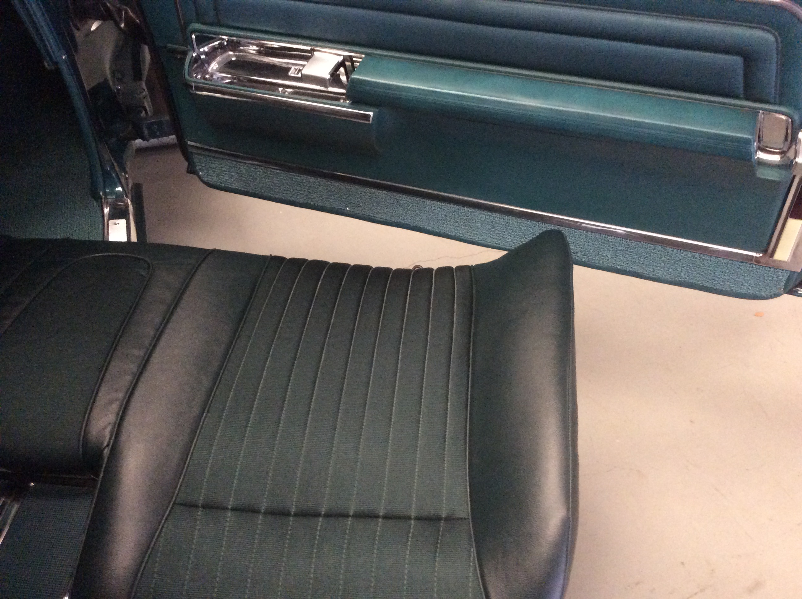

That’s a nice looking car Francois. If you are interested in recovering the seats to match the doors I may have a solution.

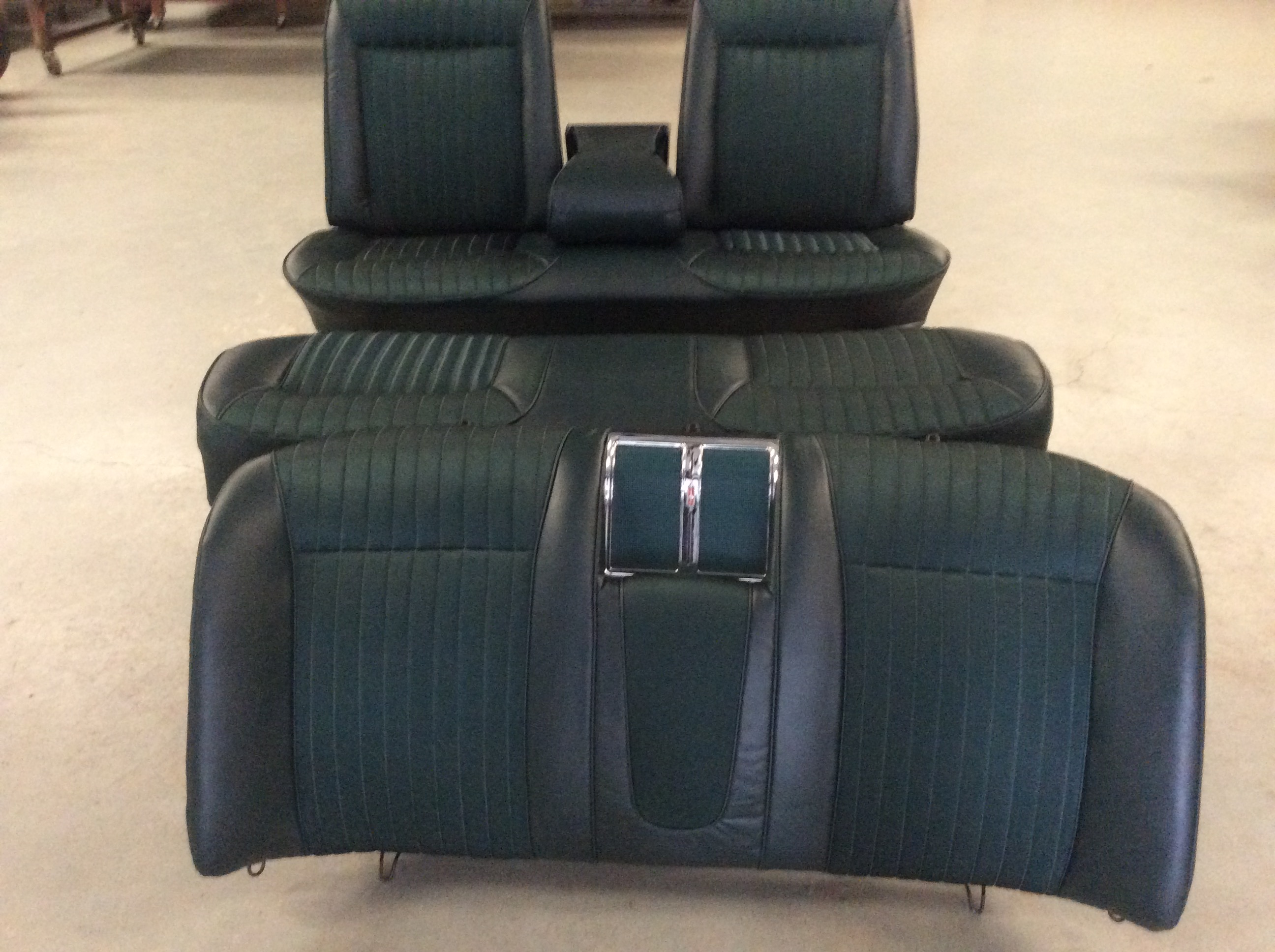

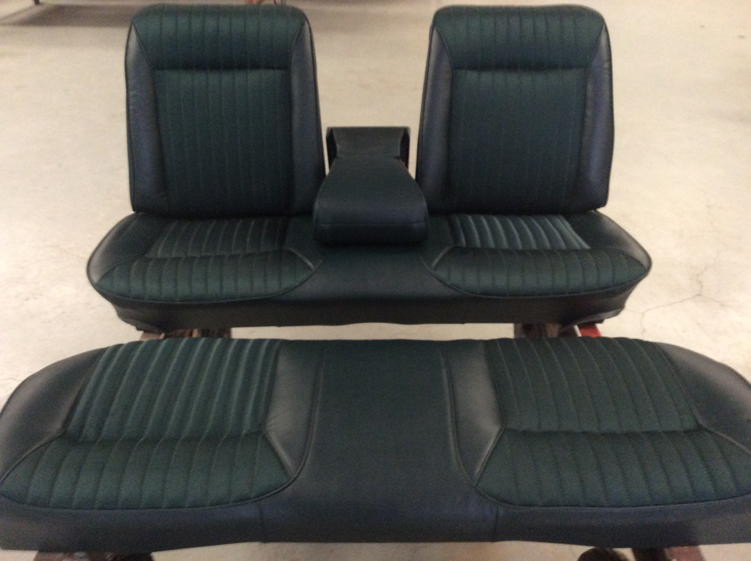

I had a guy redo my seats, front and back, for my 66. They came out beautiful. But they were the wrong color for my car. My door panels and headliner are turquoise and he did the seats in a very dark green. It looks like what was your original color.
I have ordered the turquoise materials from sms and having them redone. I’m sure I could get you a good deal on the green covers. I’ll post pictures later today.

Sure, why not, if you have pictures, that could be great. I don't know if mine look like dark green because of the sun or if everything had been changed but if it could match the color, I'm in
I also asked samples from SMS but they looked a lot clearer than what I have.

Here are pics of the seats. And one of the contrast to my original.

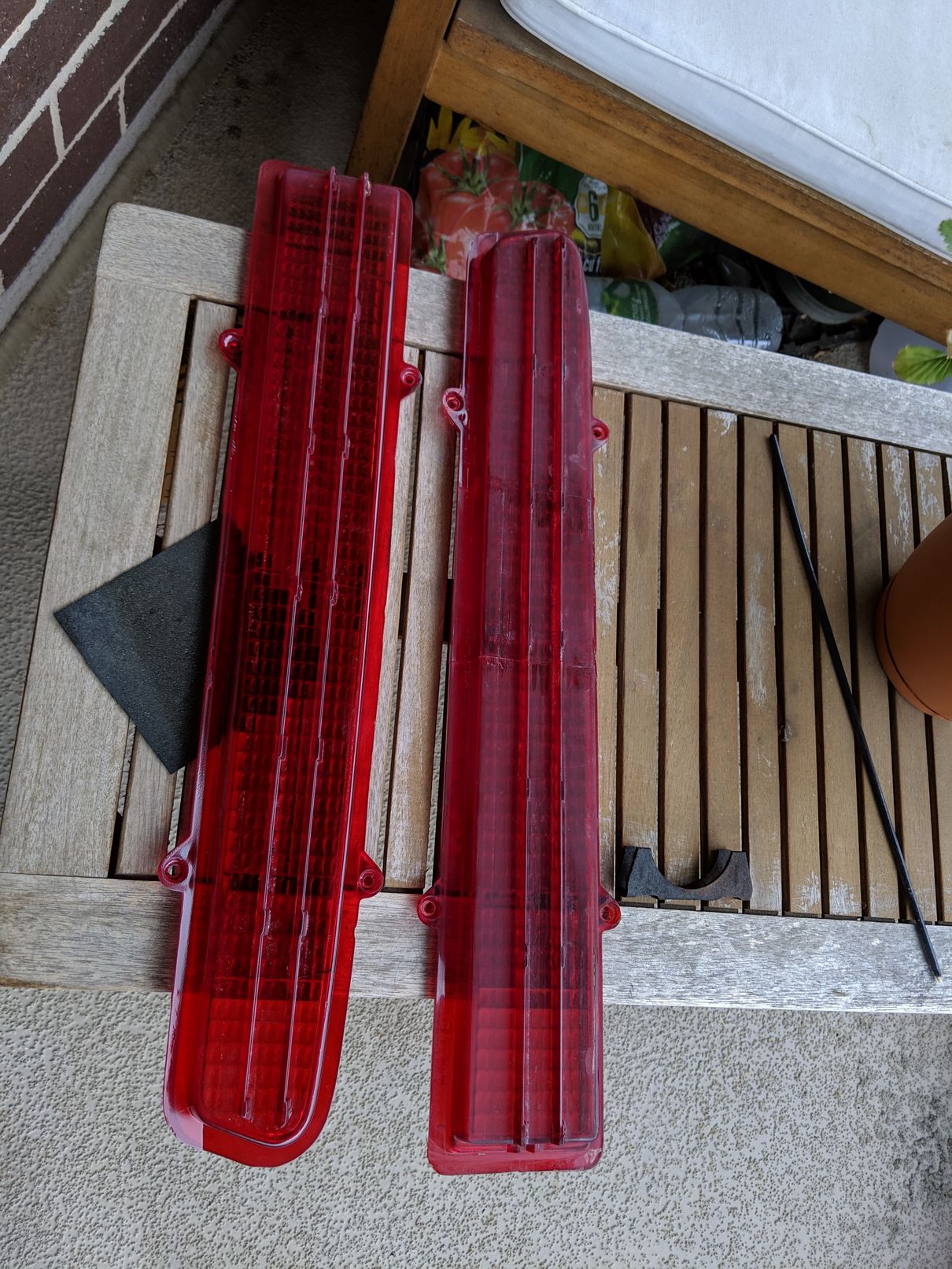

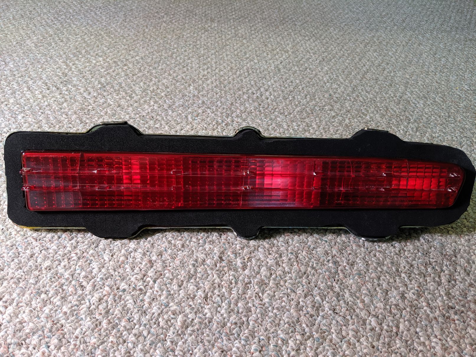

- Restore the rear lights

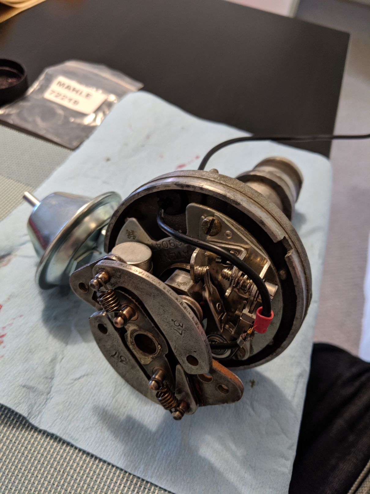

- Restore the distributor

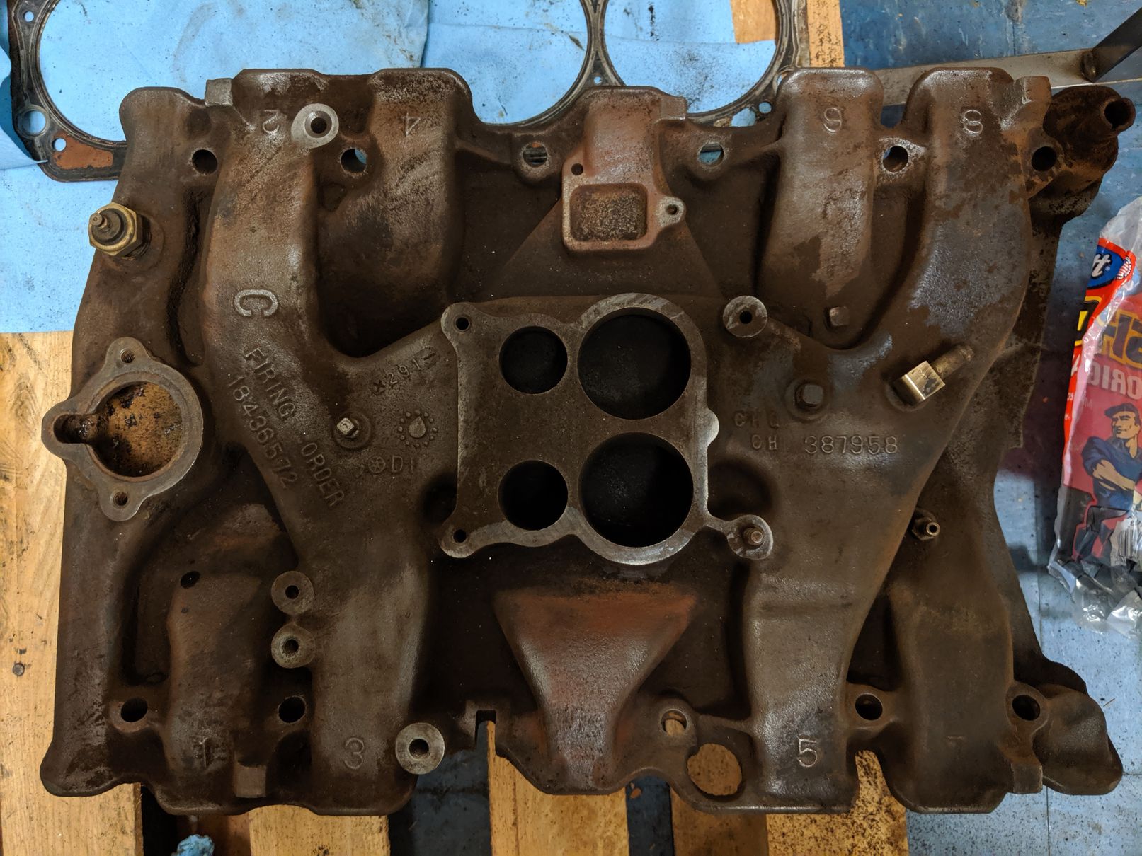

- Remove the intake manifold

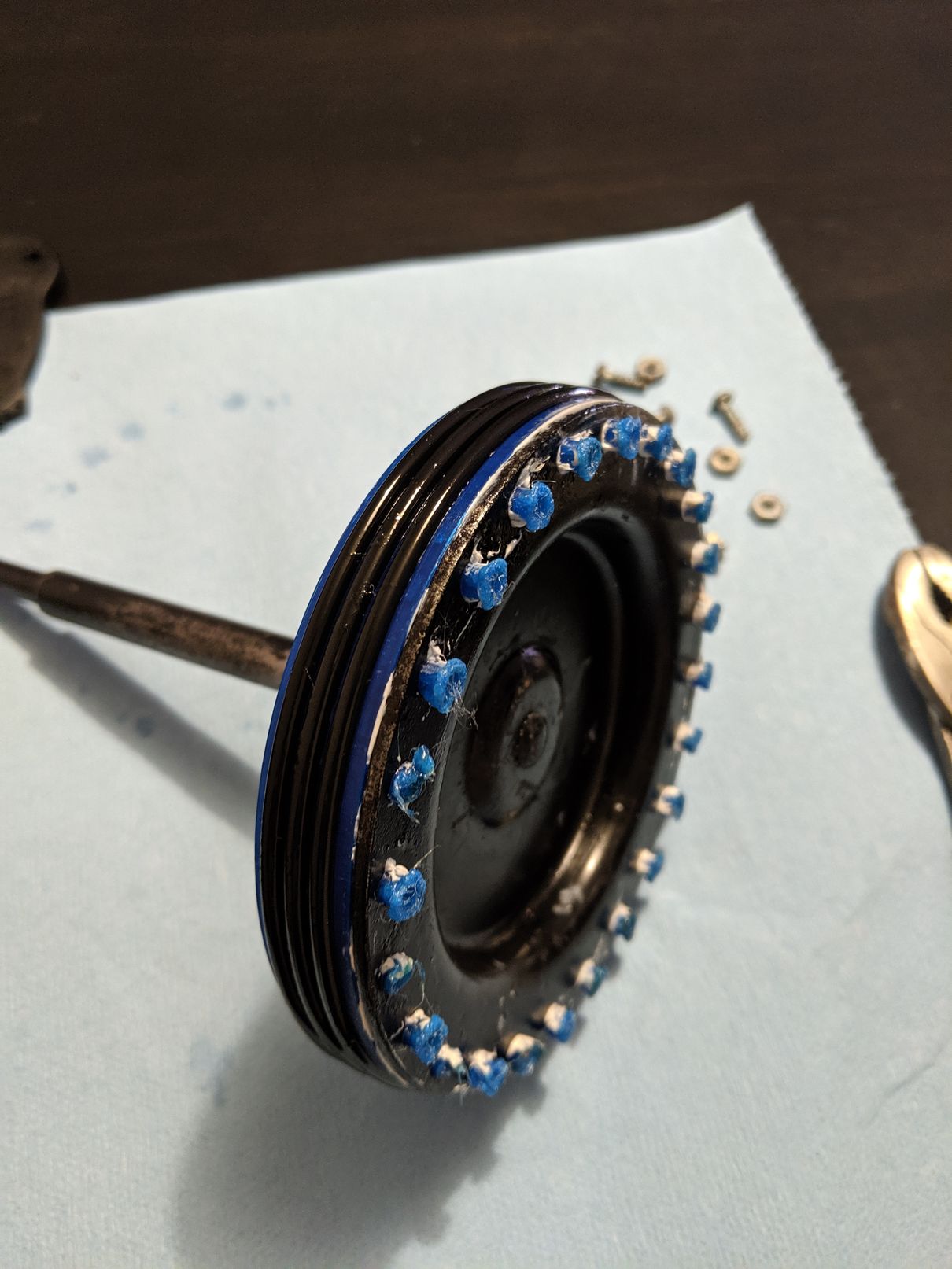

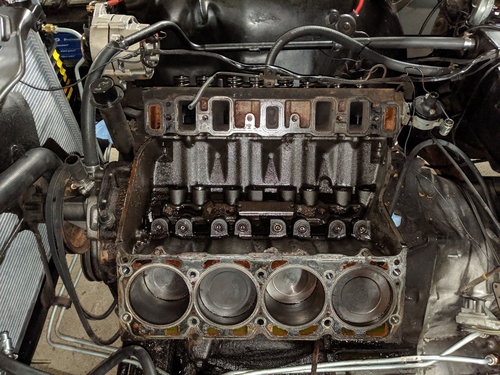

Most of the time, the problem comes from all those vacuum lines that are too old, and changing them just fix it right away. In my case, it did not. I then opened both canisters to find that one of them has the conical spring nearly rusted out and both had old rubber seals. Thanks to John (aka toroguy) I have a new spring on the way, but rubbers are incredibly difficult to find, so I printed a new support that I could fix on the shaft and apply "easy to find" O rings on it. After a few tests, it seems to work great ! We will see on the car of course...
One quick question, I need to find new bolts for my cylinder heads, I found the Edelbrock 8558 kit or the ARP 180-3600, anything you would recommend ? I have stock head cylinder.
Thanks, here are the pics.

- New exhaust line
- Remove one cylinder head

Regarding the headlight canister, I know this is a frequent problem for our 66 - 67 Toronado, so I figured I could spend more time on this.
