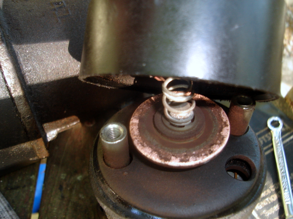

The starter solenoid is sticking. (most likely) You can probably fix it yourself byt taking it apart, cleaning the little disc thing inside, and reinstalling it. The same thing happened to mine a few years ago. I'll look for the photos of the procedure.
Hit the side of the starter with a crowbar or hammer and I'll bet the car will start. It might work for a while and then you'll have to hit it again. Eventually you'll need to fix the solenoid or replace it.

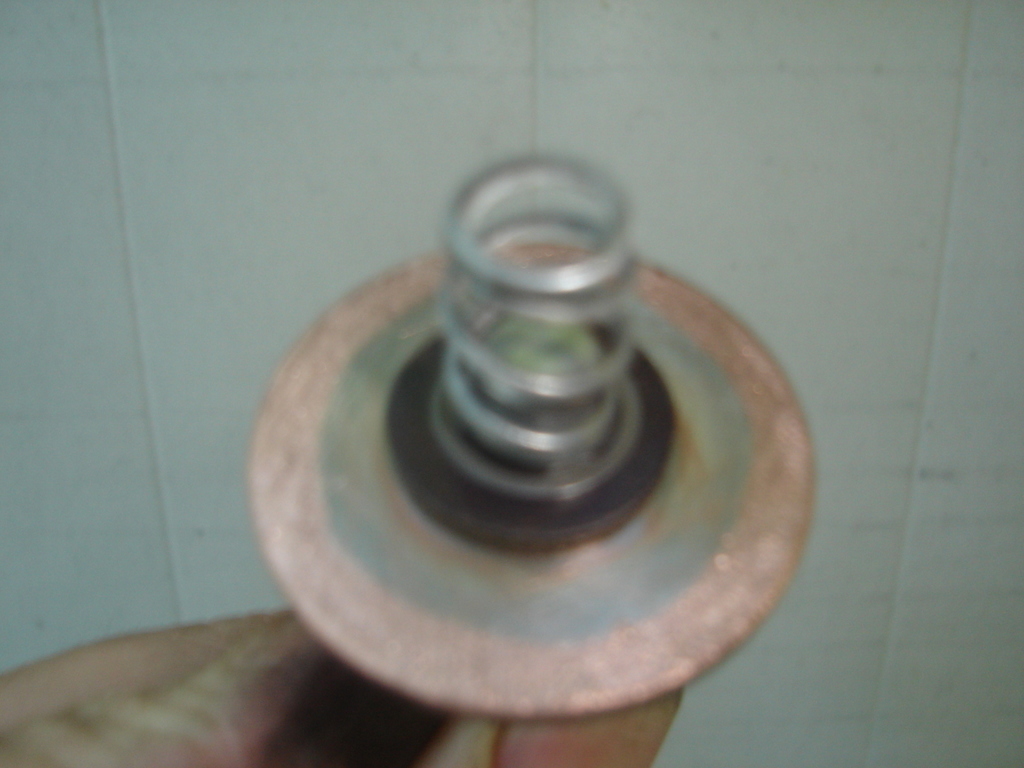

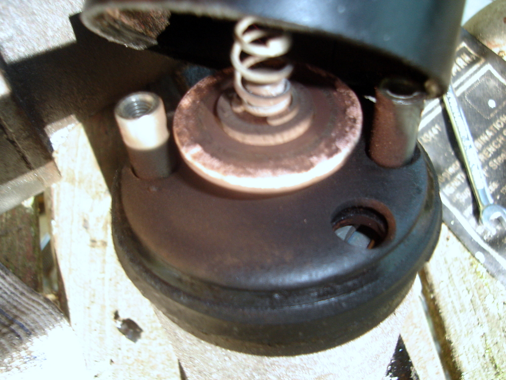

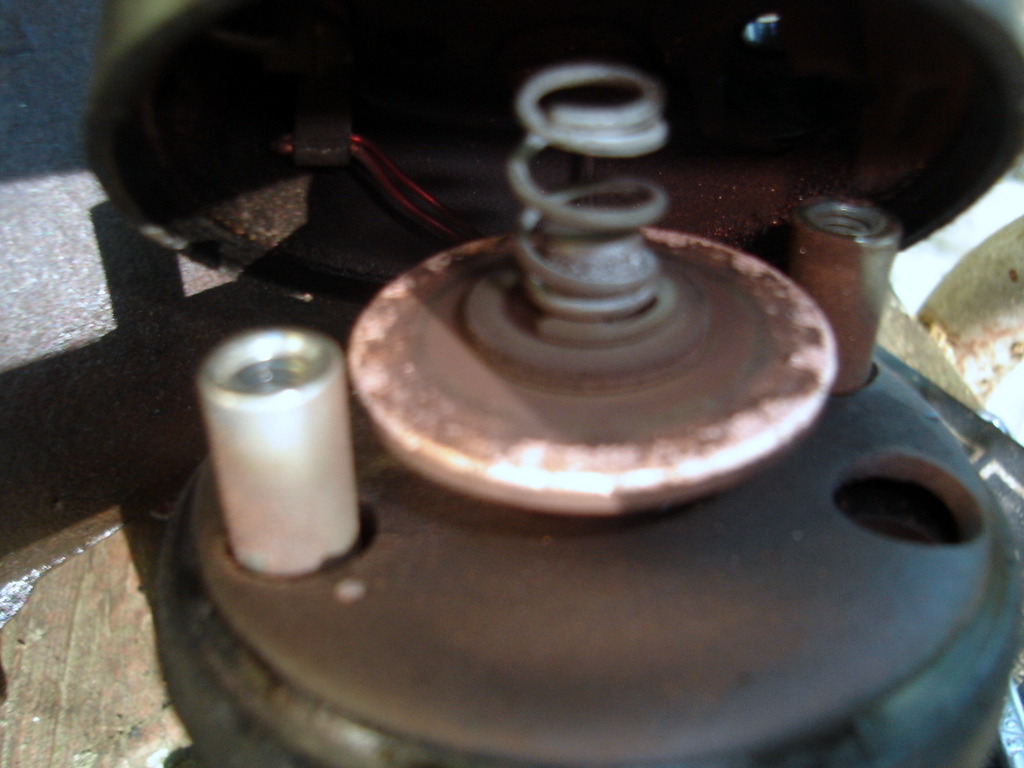

Here are some bad pictures of my solenoid. I took it apart, cleaned everything, wire brushed the little contact disc and put it in upside down so the clean side could get some use.
- DSC04450.JPG (331.14 KiB) Viewed 20277 times
- DSC04449.JPG (419.93 KiB) Viewed 20277 times

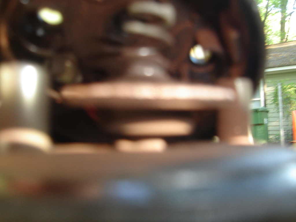

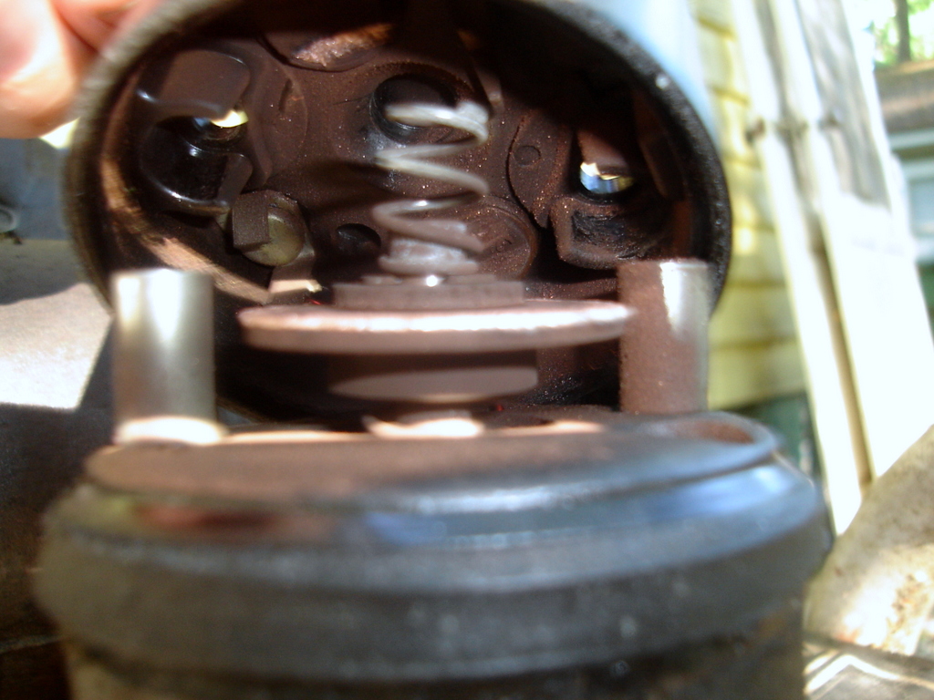

More pictures as I found the solenoid.
- DSC04452.JPG (417.5 KiB) Viewed 20277 times
- DSC04451.JPG (364.08 KiB) Viewed 20277 times

Here's the disc after I cleaned it up.
- DSC04454.JPG (284.24 KiB) Viewed 20277 times
- DSC04453.JPG (266.2 KiB) Viewed 20277 times

The other possibility is that the starter gear is hung up on the flywheel (broken teeth or something) but if it didn't make a starter type noise first, the gear probably never contacted the flywheel. My money is on the starter solenoid.

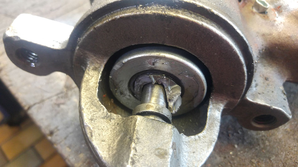

I don´t know how this happened
- ll.jpg (93.23 KiB) Viewed 20273 times

Well a replacement bendix should take care of it, probably a universal part. I
wonder what country made that one?
The flexplate for the 66-67 Toro had a very bad reputation with gear teeth
wear. Better check out yours. After that they made a special one for Toro
with longer teeth to handle the stress. I managed to find enough of them
for all my cars. Unfortunately it won't interchange with the 425 flex plate.

Thanks, i check it today,
if possibe I want to make Pictures,
