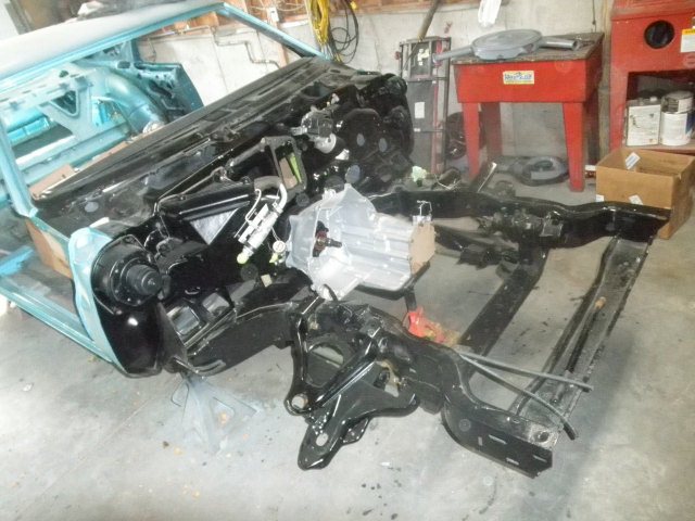

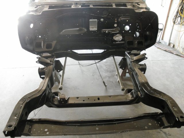

Here is a progress report for those interested:
Front frame rails all cleaned up and painted.
Cowl panel all cleaned up and painted.
I just degreased an solvent cleaned the torsion bars. They have no rust or pitting and are indeed the green colour others have noted.
Next step is to install the brake and gas lines(stainless from ClassicTube)
- P7140021.jpg (54.41 KiB) Viewed 19453 times
Cheers, Jim

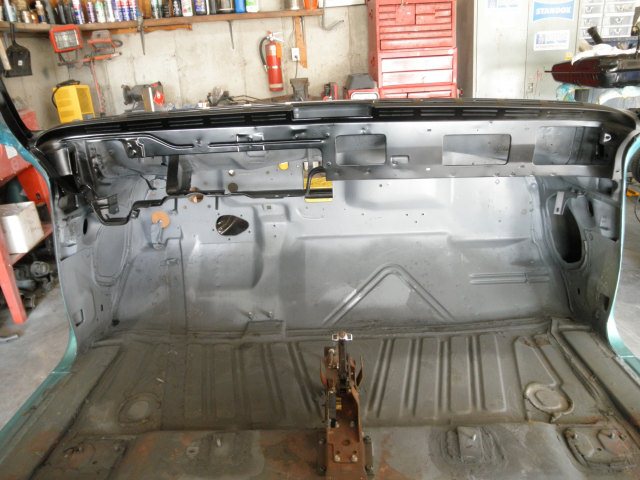

Top of dash, as well as underneath the dash has been refinished.
I was very surprised to discover that there is not a stitch of primer or paint way up underneath the dash. I removed everything to gain access. There was very mild surface rust. I masked off the complete car with plastic. So I could lightly sandblast these areas without filling all the nooks and crannies full of sand. Lot of work to basically sandblast for 5 mins. Worth it though. Sand blasting sand flies everywhere.
- P7140017.jpg (65.04 KiB) Viewed 19453 times
Cheers, Jim
TOA# 146
TOA# 146

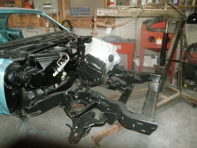

Re: In deep with my 68

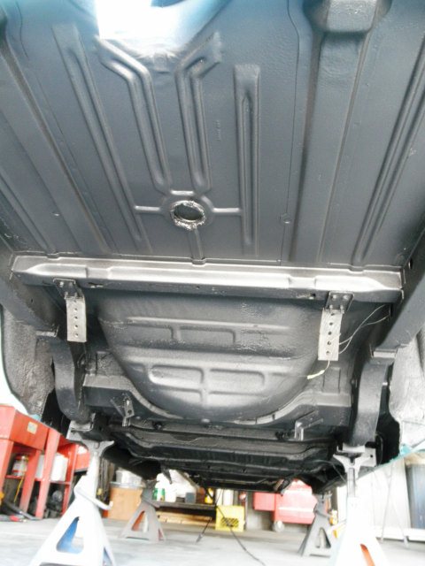

Underneath is also all ready to go.
All cleaned up ready for new:
brake lines
gas lines & hoses
shocks, all four
rebuilt gas tank sending unit
bushings for leaf spring, 3 for each spring and shackle
rear frame mounts.
brake lines
gas lines & hoses
shocks, all four
rear frame mounts.
- P7140019.jpg (56.98 KiB) Viewed 19453 times
Cheers, Jim
TOA# 146
TOA# 146

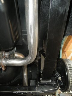

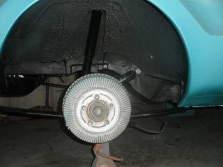

Back endi s starting to come together
- P8190054.jpg (17.18 KiB) Viewed 19422 times
- P8190053.jpg (17.23 KiB) Viewed 19422 times
- P8140042.jpg (13.96 KiB) Viewed 19422 times
Cheers, Jim
TOA# 146
TOA# 146

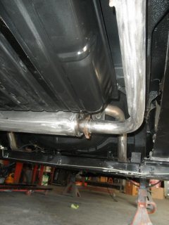

A few more pictures for those interested
- PA100035.jpg (52.39 KiB) Viewed 19368 times
- PA090030.jpg (69.54 KiB) Viewed 19368 times
- PA060026.jpg (66.11 KiB) Viewed 19368 times
Cheers, Jim

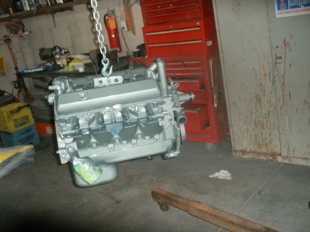

Hey Bruce,
I will post a few pictures when my laptop returns from warranty repair. It has software to resize the pictures, required for this site.
I thought about installing the motor and tranny (with final drive) altogether as one unit. I also thought about installing just the tranny and final drive like you did. I finally decided to install it all separately.
The final drive was a bit of a bugger to get into place. I installed it after installing the motor. I lifted it into the engine compartment and onto a floor jack. I then just lifted into place. It was very difficult to install using the engine hoist. It was very difficult to achieve the proper angle as it kept swinging around. If I had todo it again,I would install tranny and drive together. I cannot believe how heavy the final drive is.
