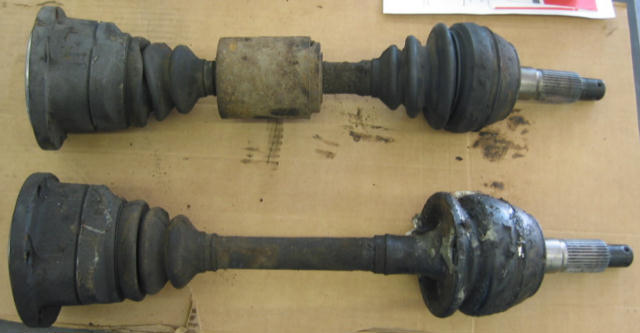

I'm pretty sure the originals looked like this:
That is the only kind I have ever seen at least, and that is what I have. (the pictured axle is a 69, but they were the same minus the input size)

Your axle shows the outter boot i am talking about. Its the replacement type with ONE fold in it. I've found that this pulls off or tears pre-maturely. The inner boot is the original, but NOT the outter. Here is a pic for comparison of what an original OUTTER boot looks like. Note one axle looks like yours while the other one has multiple folds on the boot.

1. I thought the shafts with the dampers were '66 right side only. Eliminated in '67 or maybe '68? Am I wrong?
2. I don't know of ANY place to buy boots from, of any style. Good thing I have a batch of axles...
