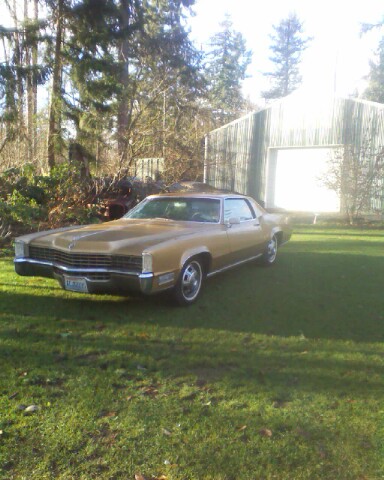

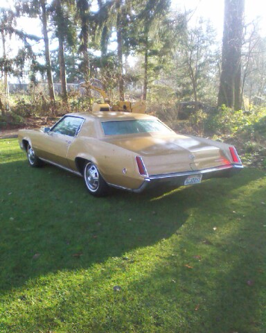

OK first of i have a 68 Eldorado not a Tornado(don`t be hating) but there does not seam to be a support group for these so i`m going to rely on you blokes. But before you start throwning darts i do have a 67 442 so i`m not all that bad.
So here`s the delima i`m rebuilding my front end and front brakes so i`ll having all the drama of expensive bearings and new rotors unavailable. I got a new bearing kit from the local parts store but the bearings were nothing like what came out so i`m stuck with haveing to use $480 worth of original sealed units then as i said before no rotors!!!. I ve heard that 70 eldos use different spindles so i looked at one and noticed that the calipers are different so i looked up the wheel bearings for a 70 and they list the same ones that they gave me originaly that did not work on my 68.
So i`m thinking that the bearing set up in the spindles themselves must be different and the parts store didn`t know any better?
Long story short what is the best readily available disc brake / wheel bearing set up for my car?

Man, I love the 67-68 Eldos...
Truthfully I hate to look at them....the urge to go bring one home is just way to strong everytime I view one...

Beautiful car by the way.
