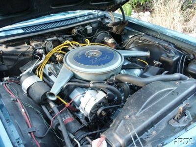

66-7-8-9 is slate blue specific to the toros as shown in the 67 and 69 Fig 1 Fig 2
In 70 motor (all big blocks 455) regardless of application A,B,C or E body changed to an Oldsmobile "Corporate" color, a darker blue metallic color, and (i believe) it carried through 76, best photo I have Fig 3
I personal would use the USA parts engine paint. It takes a bit longer to dry it seams to be a bit tougher than that available from Fusick.
