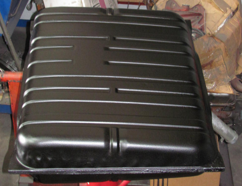

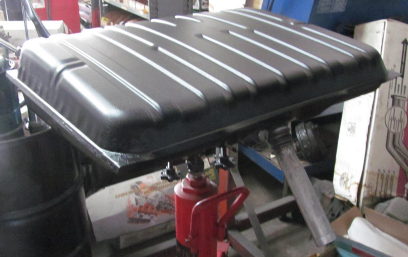

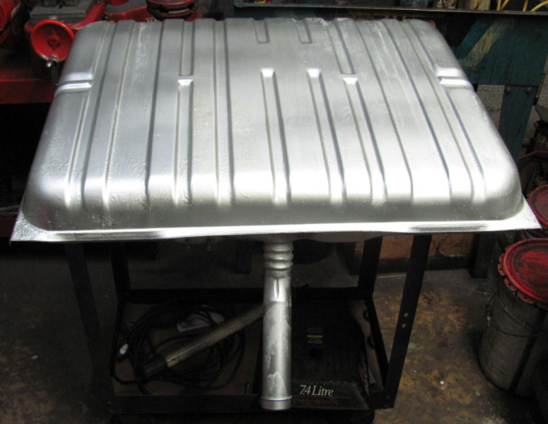

As promised, here are photos of the gas tank.
- Wire-brushed and primered with something - I don't know what.
- IMG_1597a.jpg (106.99 KiB) Viewed 17038 times
- Finished with some kind of undercoating. POR15, I believe.
- IMG_1611a.jpg (106.7 KiB) Viewed 17038 times
- Good as new. Maybe better.
- IMG_1610a.jpg (121.13 KiB) Viewed 17038 times

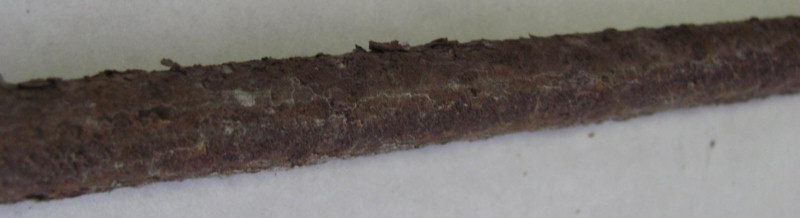

Photo of my 43-year-old fuel line (removed from Toronado). This is the one that ran along the right-side frame rail. It is one of a pair of fuel lines. My mechanic replaced the entire fuel line from tank to carb.
A long time ago I read something that went like this:
Once iron ore is processed into steel, it then immediately begins the reverse process of turning back into iron ore.

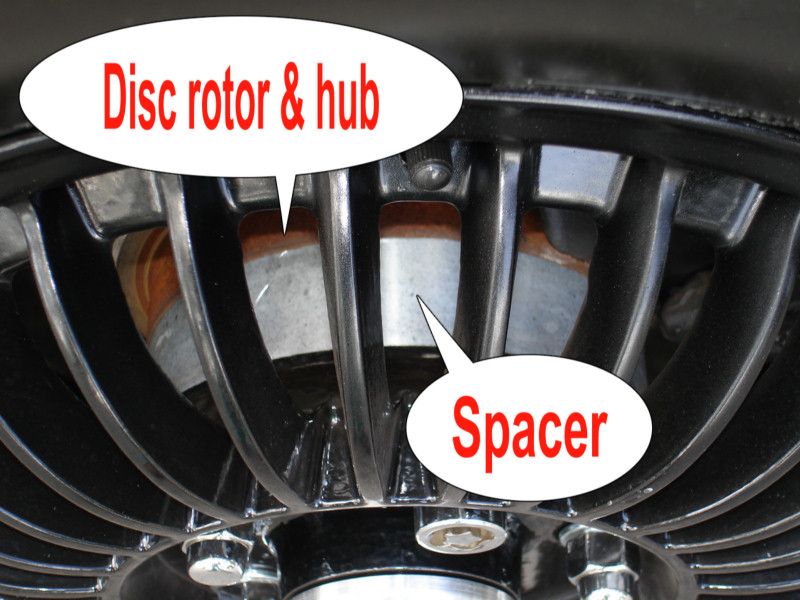

Upper and lower ball joints were replaced September 2005, at 25,314 miles. This was done during the front disc brake installation.
Upper and lower ball joints were again replaced June 2011, at 31,088 miles. This was done during the fuel system restoration (install remanufactured sending unit, replace fuel lines from tank to mechanical fuel pump, refresh fuel tank).
That's 5 years and 9 months, and 5774 miles, between replacements.
I have a guess why the ball joints seemingly wore out prematurely. I altered my Toronado's steering geometry when I installed custom wheels over the disc brakes. Initially, the custom wheels did not clear the disc brake calipers, so I had to install (you guessed it) custom spacers (also known as adapters) to push the front wheels outward about 1.5". This rectified the disc brake caliper clearance issue. Perhaps this created the premature ball joint wearout issue. Does anyone not agree?

I would think that would have a greater impact on the wheel bearing. The Ball Joints should not see much difference. Did you lube the ball joints regularly? It is possible that they dried up.
- Chazzer
- Posts: 120
- TOA Membership Number: 146
- Location: Ontario, Canada
Re: USA Parts Supply - a reputable company
Wow! They certainly did wear out prematurely.
I'm not an engineer or even a front end mechanic but something had to cause all four ball joints to fail at least 1/10-1/20th of their designed life span.
It's not like your driving the car in harsh weather conditions all year round. You have about 1000 miles a year and your down in FLA.
Perhaps the spacers are contributing some how. Every time you turn the wheels the steering geometry is not as it was initially intended. You wheels are three inches outboard then normal. Maybe this does cause extra stress on the whole front end.
Did your mechanic have an thoughts on the matter?
