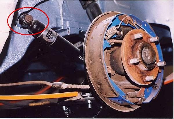

Postby Eightballz » Sat May 07, 2011 2:22 am
hi guys,
the last things i need to get my toro back on the street are the upper bolts for the rear horizontal shocks. u can see them in the picture....can someone tell me the size of these babies?
thx and bye

Postby 69W34 » Sat May 07, 2011 8:28 am
Eightballz wrote:hi guys,
thx and bye
What is the issue?
The bolt goes all the way through the frame with nut on the other side, its not something you'll get off the shelf.

Postby Eightballz » Sat May 07, 2011 9:39 am
hi,
the issue is that i'm from germany...we have the metric system, so its nearly impossible to go to the next car-shop and get the right bolts. i need to order them at a special mailorder here in germany...for those guys i need the size and thread pitch. my car came without the bolts.

Postby 69W34 » Sat May 07, 2011 11:39 am
Eightballz wrote:hi,
@ twilight: that would be sooo cool ;)
R i g h t . . . . They are grade 5, 1/2 inch (.500 mm) diameter, 7-7/8 inches (175.0 mm) over all length, thread length 1-1/2 inches (40.0 mm) with 13 threads per inch -- bolt head size 3/4 inch (19 mm)
forsee link / chart for 1/2 - 13
http://www.portlandbolt.com/technicalin ... pitch.html
Nut grade C /8 prevailing torque lock USS course thread nut with one flat washer at nut end. This should help to get a cost to make them.
as it is I have a set that i may be able to provide, depending on what you find in the way of cost to have them made.
Good luck
thx and bye
Hey Eight, are those composite leaf springs? I'm trying to get a guy here to make a run of some correct steel tapered mono-leafs but we haven't come to terms yet! How do you like those you have?

that pic is not mine...found it under http://www.toronado.de ..just took it to show the bolts i needed. as far as i know..the owner just painted the original spring leafs
bye
