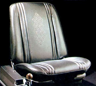

Hi Toro people in the know,
Concerning the interior options on a 68. Is this seat pattern an option? It seems pretty rare. I wonder what interior code this would be. Would you know if the rear seat has a similiar pattern as this? Is the pattern in the middle embroided with thread or is it embossed? I wonder if a auto trim shop could duplicate this pattern? Has anyone ever haerd of anyone achieving this...just curious..
Thanks, Jim

Postby 69W34 » Tue May 24, 2011 7:05 pm
This is an embossed pattern and found only on the 68 toro base models whether it was a bench or the buckets. It would be difficult though not impossible to have reproduced. Darwin's points as to differences in details of first gen toro buckets are well taken. However those points aside the seats of any first gen 66-70 toro will fit any other year provided you have the proper seat mounting points and locate them in there position.
