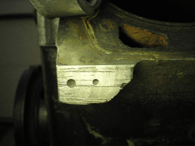

Have been cleaning the block up a bit before it goes to the machine shop. It has no numbers, just two holes drilled where the numbers should be, It is a "D" casting. I have not measured bore or stroke to verify that it is a 425. Has anybody seen this before? Maybe a factory supplied short block?

That is what I thought, the casting numbers match, but I was wondering why there are no chassis matching numbers on the land. It's blank with the exception of two drill marks and some scratches. See photo 2)

bluecab wrote:That is what I thought, the casting numbers match, but I was wondering why there are no chassis matching numbers on the land. It's blank with the exception of two drill marks and some scratches. See photo 2)
Could be stolen
Not that it would do any good since the numbers arent individual-vehicle specific in that year. But, someone may not have known that.
Re: Toro Block ID
A derivative of the VIN 38M6xxxxx did not appear on blocks the until 68, the 66 -67 had their ID stamped on a boss on what would be the front of the right (passengers side) head it matched the protect o plate also the serial number found on the transmissions yellow tag also matched the protect o plate.

Thanks Bill,
My heads are at the machine shop (along with the block) I'll check next time I'm down there. They should be done hot tanking and disassembling so I'll find out what parts are needed. The lifters are done( as in trashed) and the cam looked wiped out. I found cam specs somewhere, but today I was trying to compare the cams that Mondello sells with the stock numbers I have; hard to interpret without complete specs on the stock cam. The w30 and w31 cams look pretty close but with a little more oomph. Do you think anybody on the forum has run either of these in a '66 with factory manifolds?
