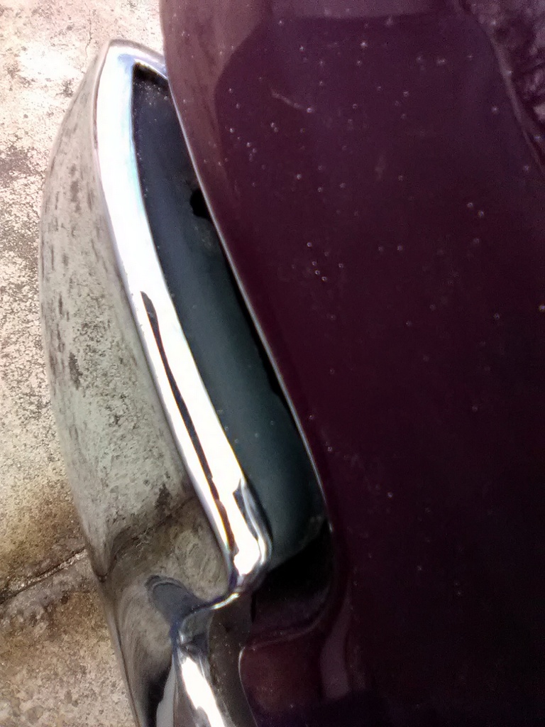

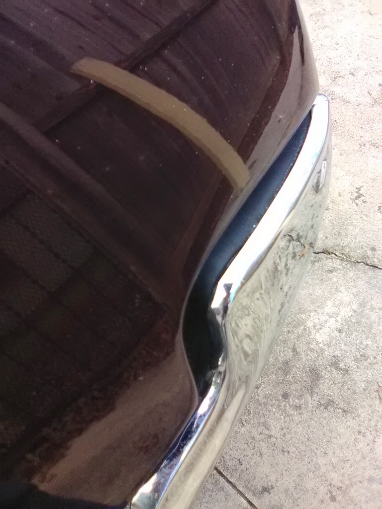

Here are the fillers for the rear bumper. The front is similar.
The install at the lip of the bumper edge at the top. I glued mine in place with black Weatherstrip Adhesive.
Toronado Bumper Fillers
- IMG_20180209_151904.jpg (243.54 KiB) Viewed 15076 times
- IMG_20180209_151854.jpg (253.29 KiB) Viewed 15076 times

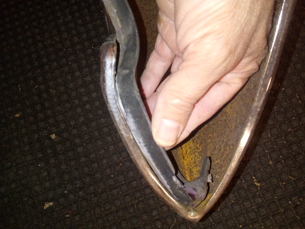

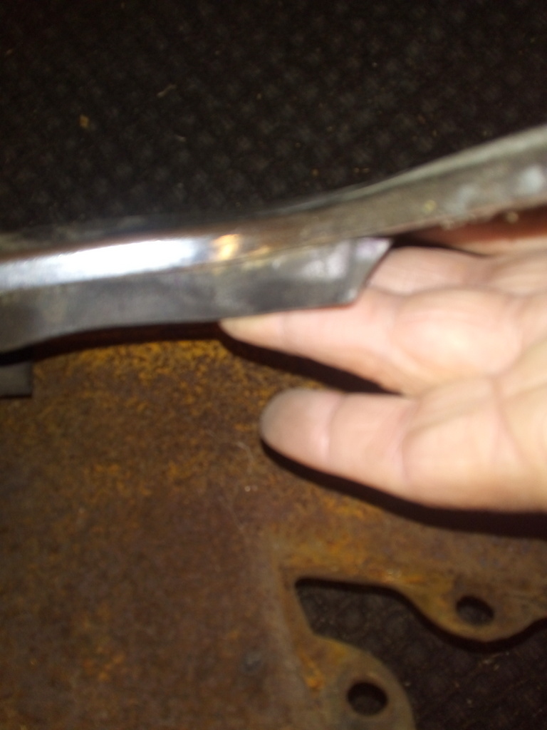

Here's a front bumper end and a rear filler. Maybe you can see how they fit together. Obviously these two parts aren't meant to go together but they're close enough to convey the idea.
- IMG_20211113_114638.jpg (164.24 KiB) Viewed 15075 times
- IMG_20211113_114624.jpg (299.37 KiB) Viewed 15075 times
- IMG_20211113_114610.jpg (316.73 KiB) Viewed 15075 times

I recently purchased front rubber bumper fillers from Fusnick Automotive Products Part# BF66EUF, for my 1966 Toronado. It is not clear to me how these are supposed to fit. If they sit on top for the bumper, the internal "V" portion does not correspond with the chrome piece which caps the end of the fender as they have two indentations which interfere with the fender piece.
If anyone has photos of these fillers installed on their car I would like to see them.
