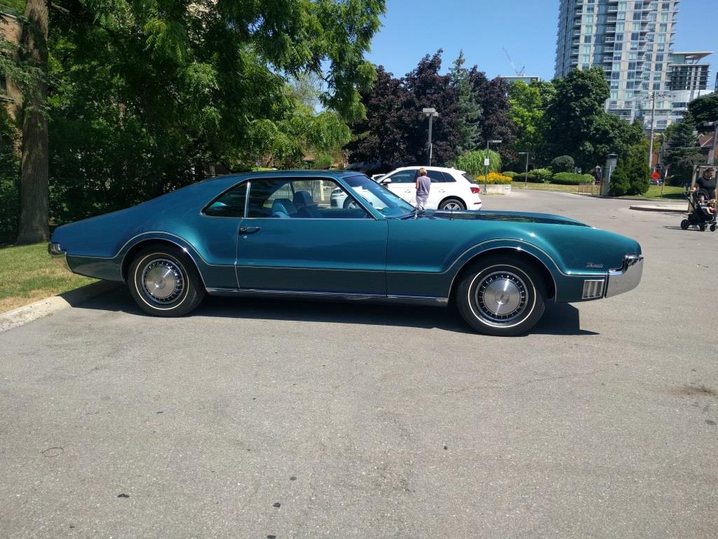

Hello,
It looks like I have to replace or repair a rear window regulator & motor on my 1967 Toronado: It will not open from the fully closed position
I've had the back seats & elbow rest panels out a few times, and have gained access to the bottom of the regulators. Once loosened from their bottom mounts (3 bolts) they work fine; but upon retightening they'll fail after a while. I believe it might be a dead spot on the motor armatures; they don't appear to be seizing.
I hesitate to remove the interior upper quater panels in order to fully remove the regulator. The manual seems to indicate that window moldings and the rear deck have to come off.
I wonder if anyone has had experience with removing a regulator (or just the motor). It would be appreciated.

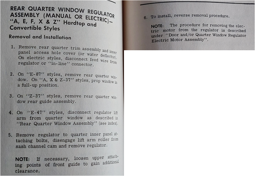

Greetings, Jody;
Beautiful Toronado!
The 1967 Fischer Body Service Manual does give some advice on the topic of removing the regulator assembly (Page 7-24, REAR QUARTER WINDOW REGULATOR ASSEMBLY (MANUAL OR ELECTRIC) - "A, E, F, X & Z" HARDTOP AND CONVERTIBLE STYLES.
Beautiful Toronado!
- FBSM P7-24.png (731.93 KiB) Viewed 23038 times

My thanks for everyone's kind replies:
Apologies for the long radio-silence
Texlbee, thanks for including shots of the relevant pages in the manual.
I made progress as a result, and was able to repair the window mechanism by repositioning the mechanism a little akimbo before re-tightening the bolts.
I figure there might have been a dead spot on the motor armature, or the rails & guides were just getting stuck in the same old place - full closed. They both work like a charm now.
My thanks again for your kind replies, and apologies for the radio-silence.
All my best, Jody
