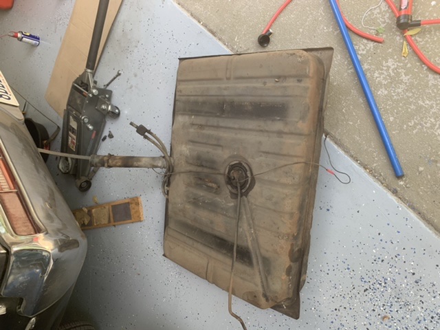

Hey guys, so I finally took down the fuel tank on my ‘69 Toronado to remove the rust and fix the fuel sending unit, but I noticed that the sending unit is sealed with a metal cylinder. I tried to pry it off, but it doesn’t budge. Is there any way to take it out and access the internals, like the float, etc.? Thanks!

Interesting, so I found out on another forum (for a different Oldsmobile) that the inside of the fuel sending unit has a hockey puck-styled float which slides up and down the canister to read the fuel level. A pretty unique and cool design…which I heard can get stuck quite often since there’s little clearance between the puck float and the canister.

After thinking about it (and doing a bit of research online to confirm my thought-process), the purpose of the canister is to prevent any unnecessary fuel from sloshing into the float, which could cause the gauge reading to fluctuate during inclination, hard acceleration or braking, etc. (small holes around it to let the fuel escape slowly). Now, the original tank does have one baffle, but if I replace it with a new sending unit that is exposed, the chances of the gauge moving around is more probable. It would kinda suck, but a working fuel gauge is better than one that reads full all the time.
I still might rebuild it, or just get a replacement from a ‘71-‘72 Toronado/Buick Le Sabre (same part). I heard that it fits for ‘68-‘69, just have to plug the second line and it (apparently) reads empty when the tank has 5 gallons left. I think you can adjust that by bending the rod that holds the float.

In the service manual for ‘69, it shows a diagram of the B,C, and E body cars having the same style sending unit, so I was confused at first when I saw it since I didn’t take down the tank at the time. For sure, I’ll try to make this one work since it seems doable.

Sorry, I meant the canister type. The A body didn’t have the canister one, just the typical “toilet tank” style.

Okay never mind haha, I can’t fix this sending unit. Since the tank was dented from the bottom, it caused the canister to deform a bit so that the float can’t move at all (clearance is precise, kinda like a piston). I just bought one for a ‘72 Toro instead and will see what I can do with that return line it has. Rather have a gauge that moves a bit when going uphill than one that doesn’t work at all.
