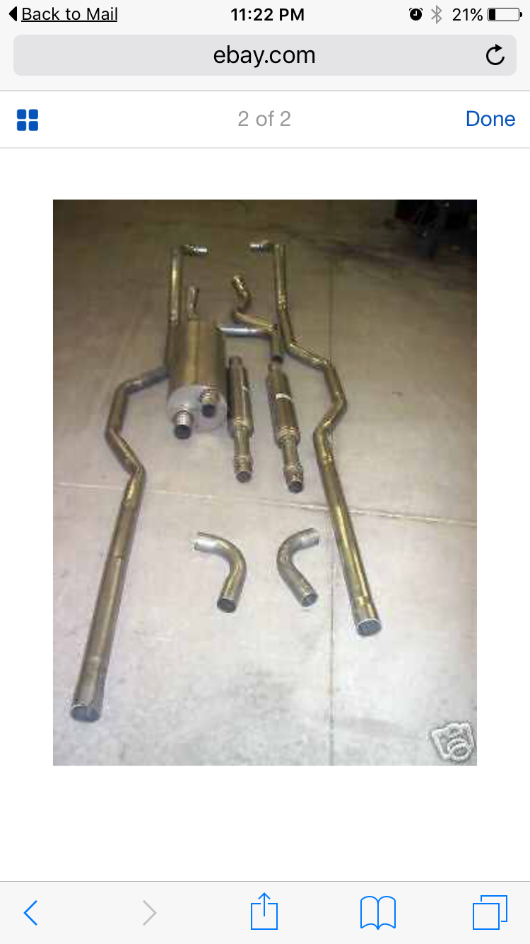

Hi fellas - I need a new exhaust system for my '66 Toro. Looking around on EBay I found what seems like a pretty good deal. Full aluminized system with resonator delete pipes for $347.60. The guy is located in Geneva, Ohio and has pretty good feedback (>4300 with 99.1% positive ). He sells systems for many makes and models. Shipping would only be $65. Looks like he's only 100 miles away so I could even drive out to pick it up. System is complete although I'm not sure if clamps are included - but they're cheap. Stainless is available for $780. On eBay the guy's name is sat1966. Anyone here ever deal with him?
The photo shows resonators - the system I want would not have them.
I see that some folks have bought from Waldrons but they are about $150 more for the same system.
Let me know what you think.
Thanks and Merry Christmas!
Ron
1966 Toro Exhaust system

Muffler is wrong. Don't buy this.

Appears to be cheap, crush-bent tubing. Buy local, pay less, no shipping cost, hangars and welded joints included. It'll still be crush-bent, though--inferior to mandrel-bent tubing. It's near-impossible to get a mandrel-bent system at a local muffler shop.
I bought an assortment of 2 1/2" diameter mandrel bends and a dual inlet, dual outlet transverse muffler. SOMEDAY I'll put a proper exhaust on my '66. Connecting the large-diameter tubing to the stock exhaust manifolds will be the worst part of that job, I think.

Doc Hubler wrote:Muffler is wrong. Don't buy this.
Doc - what's wrong with the muffler? Will it fit? I'm not so concerned about originality - but I do want it to fit / hang properly without modification and of course it has to sound decent. Thanks!

The muffler, for one, doesn't look like the right fit for the car. THose go in a specific place behend the rear seat kick up. They are oval in design, this looks round.
