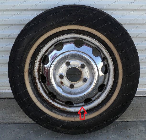

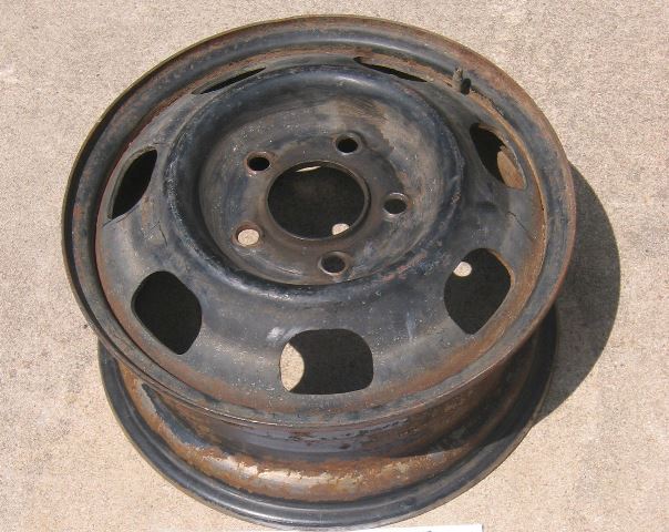

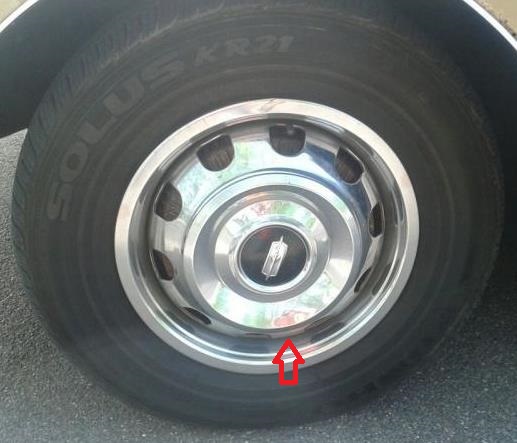

66 trim rings will NOT work on '67 disc brake wheels. The valve stem is in a different place and the width of the two trim rings is different.
Toro wheel, 10 hole.jpg (55.78 KiB) Viewed 19243 times
Toro wheel, 7 hole.jpg (63.61 KiB) Viewed 19243 times
Toro wheel,1967, 10 hole.jpg (141.64 KiB) Viewed 19243 times

Thanks Otto - that answers my question perfectly! So the valve stem location is the key. Plus I think the reinforcement plate on the drum wheels would also confirm. If I bring one of my wheels with me I can't go wrong. Thanks again buddy!
