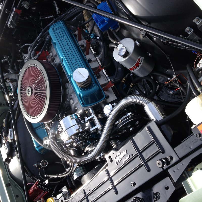

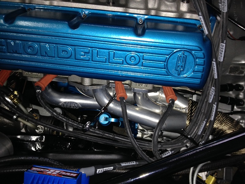

really cool thread...can you be more specific on the transmission build?

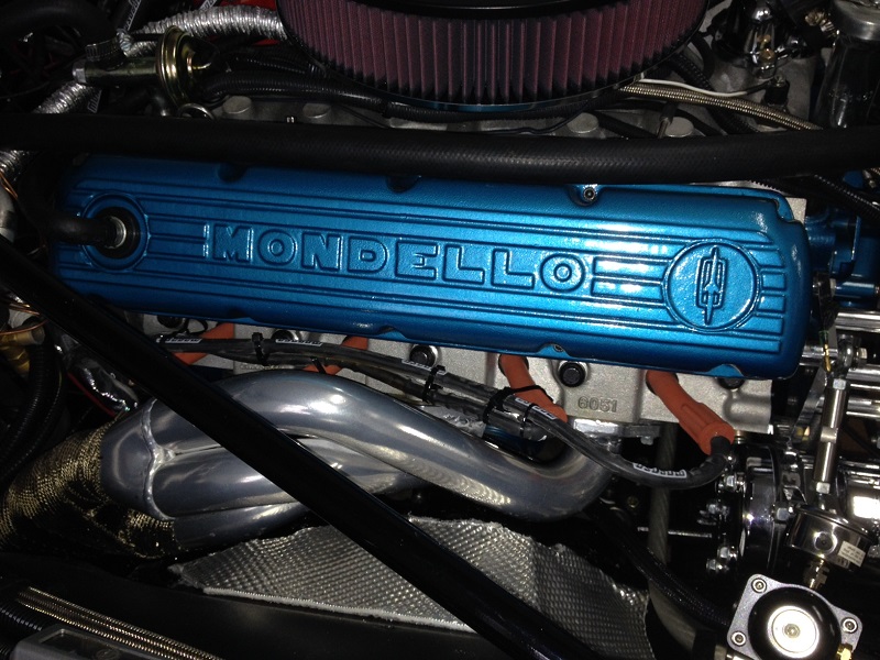

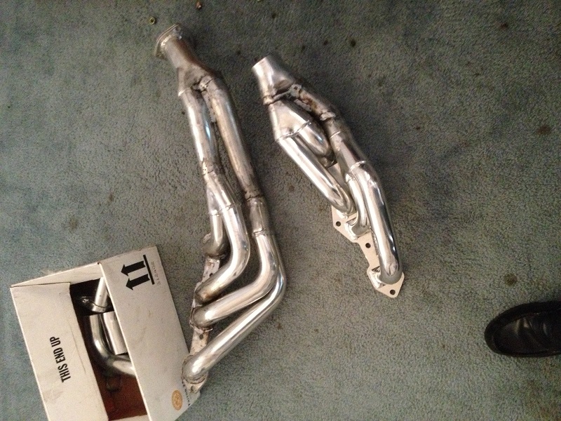

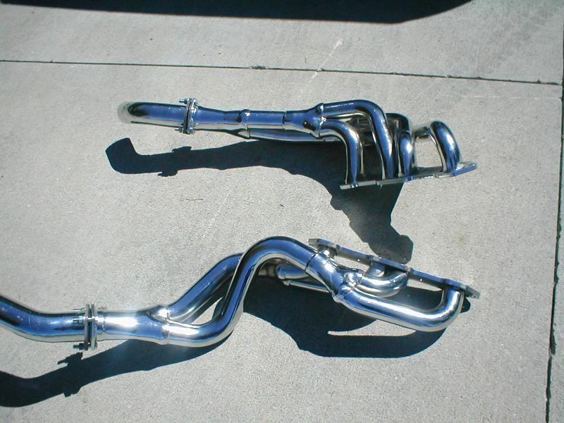

i also built a performance toro engine just like yours but with stock intake and still stock exhaust manifolds so far...gonna build custom headers soon. buddy from the US built his own headers for a 1971 (have some pics but they are too large to attach)
applied GMC sells the headers he started with
- Eightballz
- TOA Membership Number: 826
Re: th425 550hp /600 tq
here are some pics
- phodfsdfto.JPG (187.94 KiB) Viewed 21370 times
- phgfdgdoto.JPG (232.32 KiB) Viewed 21370 times
- 1251_p14788.jpg (79.14 KiB) Viewed 21370 times

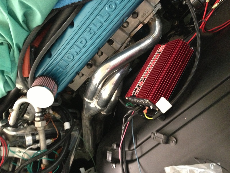

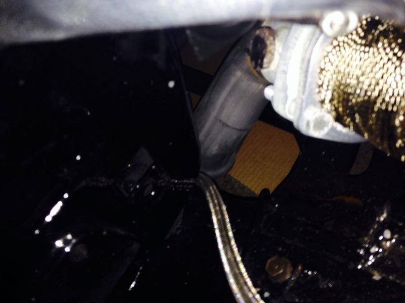

more
- photo s1.JPG (203.05 KiB) Viewed 21368 times
- photo 2.JPG (199.05 KiB) Viewed 21368 times
- photo 1.JPG (188.36 KiB) Viewed 21368 times

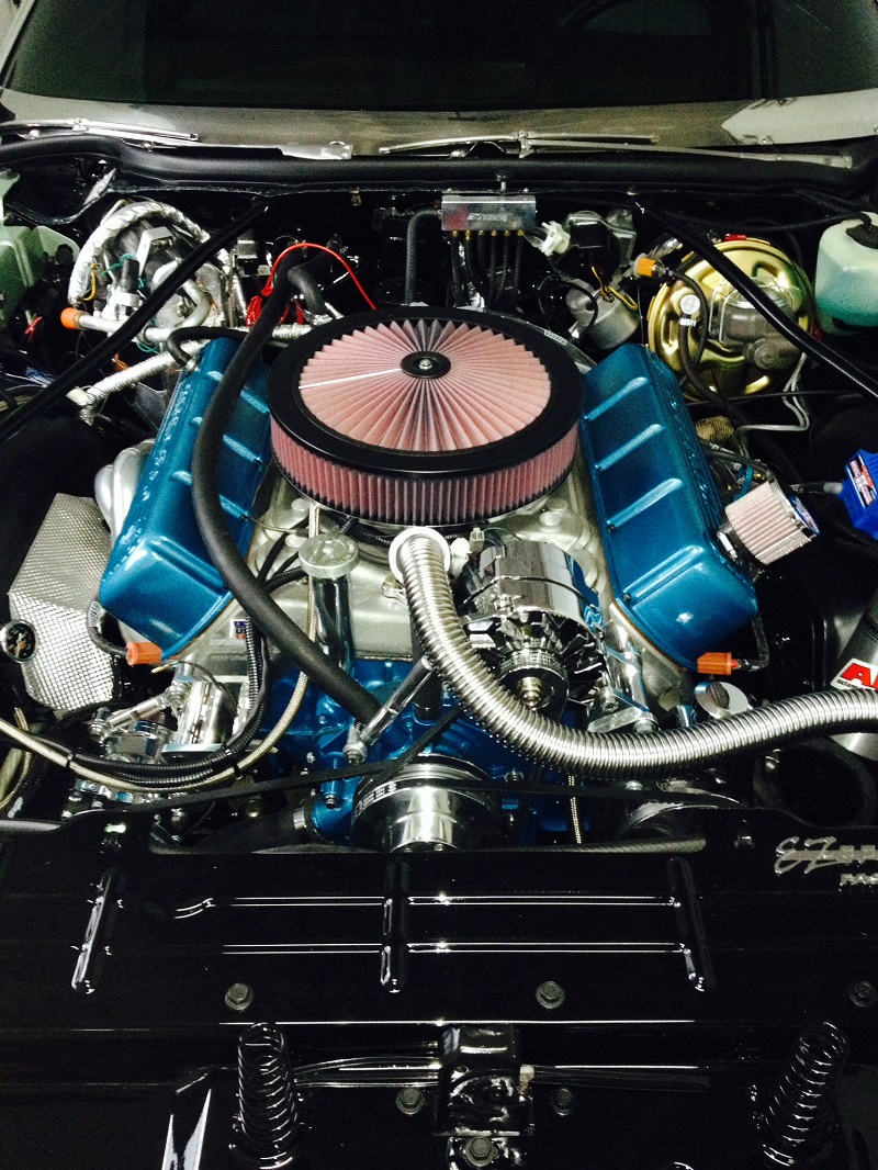

and more
- photsdfo 2.JPG (88.13 KiB) Viewed 21366 times
- photoa 3.JPG (377.03 KiB) Viewed 21366 times
- photo.JPG (298.46 KiB) Viewed 21366 times
