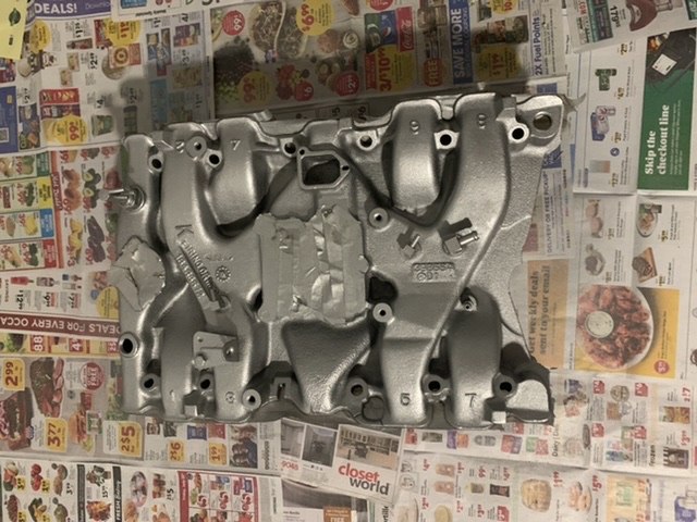

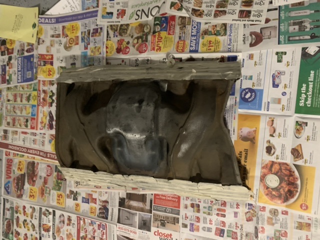

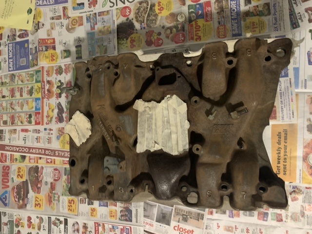

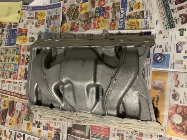

I got the heads and manifold back a couple of days ago, valves replaced and the manifold washed. I also painted the manifold to make it look a little nicer:
