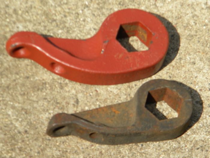

Bcroe,
The Pictures You Show Are The Adjusting Cams For The Torsion Bars. These Are Not The Crimped Metal Caps To Which I Was Referring. Those Metal Caps Are Crimped Or Peened Onto The End Of The Bar. The Cams That You Show Slide Over The Caps.
Torsion bars and spings
Postby bcroe » Fri May 02, 2014 8:07 am
Doc Hubler wrote:Bcroe, The Pictures You Show Are The Adjusting Cams For The Torsion Bars. These Are Not The Crimped Metal Caps To Which I Was Referring. Those Metal Caps Are Crimped Or Peened Onto The End Of The Bar. The Cams That You Show Slide Over The Caps.
Oh, sorry I didn't understand. You are talking about the manufacture of the bar,
before the enamel went on. Of that I know nothing. Bruce
