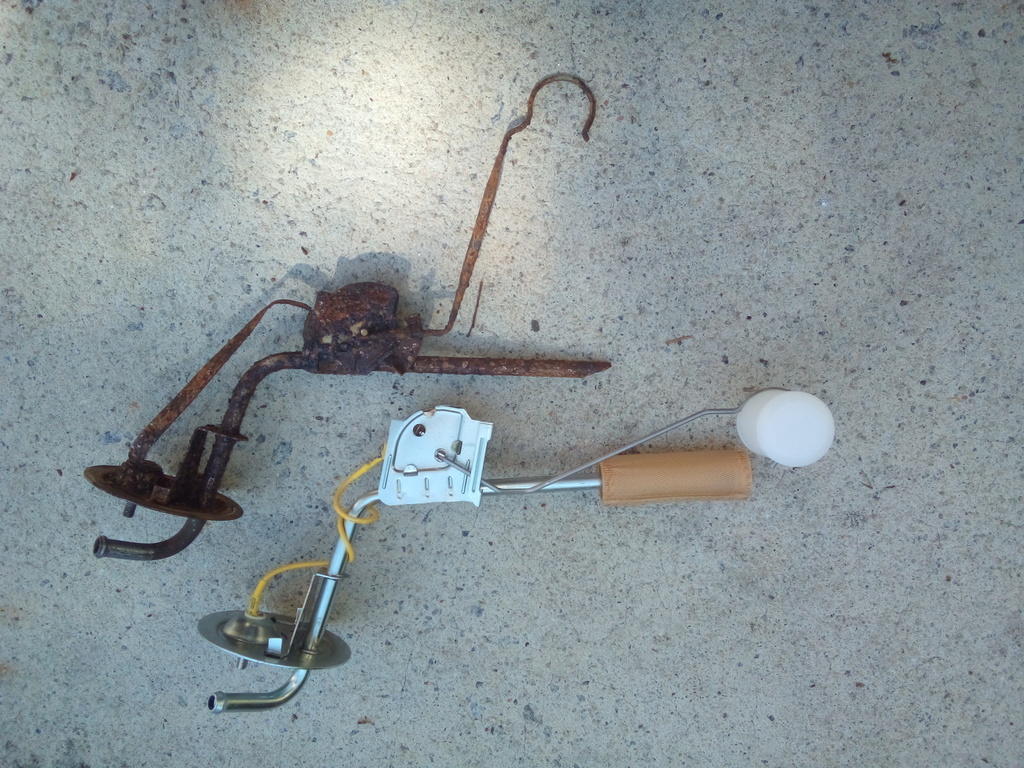

Nice job (and car)! That old sending unit seems to have a “bit” of rust haha! It’s so nice when a gauge works since you have the peace of mind.
The float can be bent further down for better accuracy, but I didn’t do that since I was afraid that I am going to run out of gas before the gauge reaches “empty”.

So I just drove the car for a bit with a quarter tank, and the gauge needle moved around immediately when the fuel moved in the tank. On an incline and when pressing the gas the gauge reads empty. It only goes higher when I brake. Is that what you are experiencing as well Otto? It stabilizes when I am not moving or am traveling at a steady speed on a straight, flat road.

Ah okay, yeah the new sending unit is very sensitive and moves immediately whenever the fuel sloshes around. Maybe when I fill the gas tank it won't be as bad as when it is only a 1/4 full.

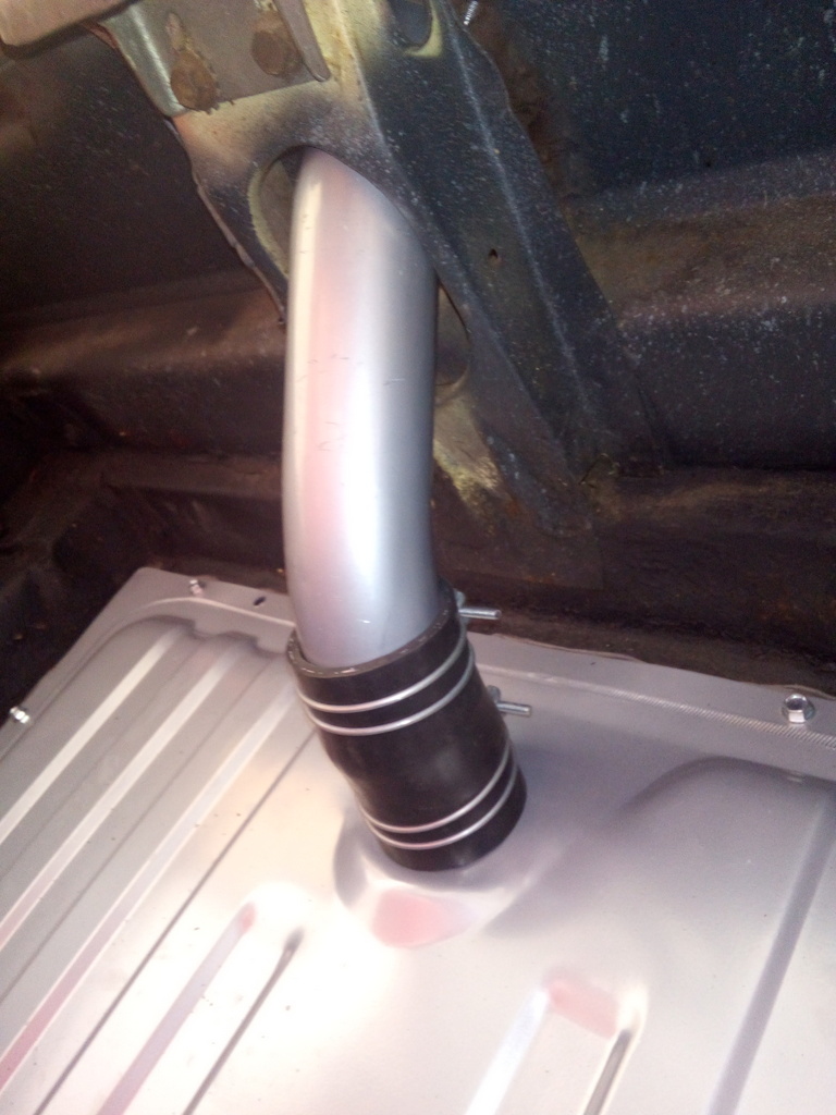

Sooo, does anyone know how to replace the rubber fuel lines that go to the tank? Mine is routed inside the frame and seems like a huge pain to replace. Also the return line broke since it’s too dry and old and now I have to take the tank back down.
Re: Fuel Sending Unit
It's a royal pain in the ass. Use a wire or electrician's fish tape to get through the frame and attach the new hose to it and pull it back through. Do the fuel line and the return line at the same time. Wrap them with electrician's tape every foot or so so they go through together.

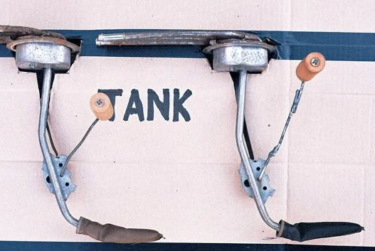

The biggest problem with gauge accuracy is the float arm. The float
motion should be just enough to touch the top and the bottom. Note
on the left stock unit, the float will not even move till the gas level
drops by 1/3. Then it drops like a rock. The arm on the right has
been lengthened and bent to work over the entire range. It will tell
me within 1 gallon, how much gas is needed to fill the tank.
This is done to all my cars, along with proper calibration of the
speedometer. Bruce Roe

Update: So I was able to fix the leak I had in the fuel tank by sealing the hole with TankWeld where the original return line port was located (someone broke it in the past and used epoxy to keep it in place, but it broke again and wouldn’t stop leaking gasoline) and using the new return line that the sending unit included. I also cut parts of the old fuel lines that were cracking and damaged and used a nylon connector to join them, as well as the new rubber lines, together. No leaks anymore! I was going to try to replace the whole lines, but the clamps that joined the rubber and the metal lines were too far in the hole where the rubber lines are supposed to be fished out.
