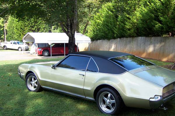

Here is an interesting toro with aftermarket wheels. Car is listed for trade, didn't contact the saler/trader for wheel details. Says they are Boyd Coddington.
http://danville.craigslist.org/cto/4132153120.html

- torowheels.jpg (53.42 KiB) Viewed 20576 times

Since you found the ad, how about e-mailing the guy to find out what the specs on the wheels are?
I would but then so could everybody who is following this thread, possibly annoying the crap out of a guy who is looking to sell a car, not become a technical advisor to the forum…

I was simply trying to be helpful by posting the link, so someone more versed in wheel specs could follow up and ask the appropriate question(s). I won't be following up with the seller.

Well, I tried to contact the seller of the toro with the Boyds wheels, no response.
