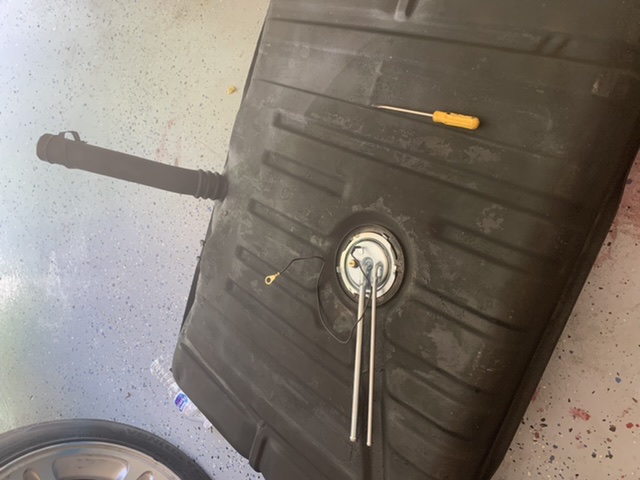

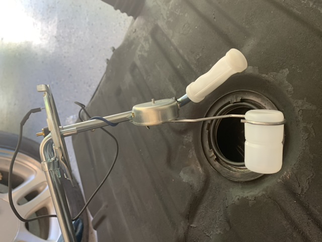

I just put everything back together, including the new sending unit, and it works! The guy (68RocketAction) that mentioned that the gauge reads empty when there’s about five gallons left is correct, but I bent the float down a bit more so it reads empty when there’s 4-4 1/2 gallons in the tank. I can also confirm that the ‘71-‘72 Toronado sending unit fits directly in the ‘69 tank. It’s the Spectra FG106A fuel sending unit, in case anyone is wondering. The gauge may be a bit inaccurate, but I don’t care, I finally got a working fuel gauge!
I was able to remove the rust and dirt that was sitting at the bottom of the tank and I can already tell that the car idles more smoothly. Going to take it out tomorrow for a drive, change the fuel filter, and put some gas in it. It has about 9 gallons inside and the gauge reads a bit more than a quarter tank.

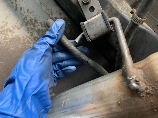

Also I replaced parts of the fuel line and return line that were ripped and had a hole in it.
